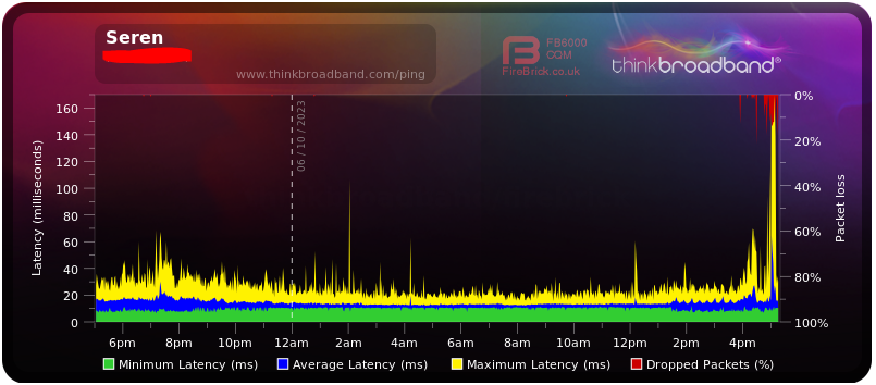

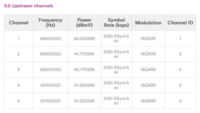

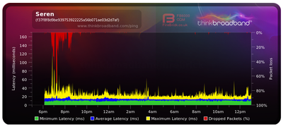

I am back again with yet more issues with my downstream/upstream. Once again we are experiencing huge drops in both download and upload (mostly the latter, I think) with some packet loss mixed in. I am currently running a fresh BQM but it's being very slow to update. I'll show the one that was working up until it mysteriously stopped after a router reset below, though as well as what the current one has to show. I do however have this issue detailed in other posts which occurred in months past. Was unsure if I should revive the most recent one or post a new one but I'll link to them here. This should give you a good idea of what's happening because the issues are exactly the same. Huge noise on the upstream across all channels, packet loss and intermittent service in general. Currently it's at its worst. My router is currently flashing like mad yet I am not disconnected entirely. Endless loop and yes, it's been rebooted. Twice today, even. Anyway, here's the links to my previous threads.

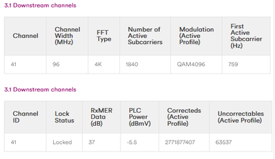

The second one was affecting both downstream AND upstream. We were told of high traffic causing problems at the time, but a tech also came to the property and adjusted power levels on the 3.1 line and this seemed to alleviate any further problems after the high traffic was resolved. He told me that due to my houses location, it's possible that we may run into more as we're only connected via an RG6 cable instead of an RG11. He said he'd contact his manager and get back to me about it. He did not, of course. Much like when phone support tell you a manager will call you back within 24 hours and that never happens either. However the numbers shown on the router show the PLC to be in spec this time round, so who knows. Not inclined to say it's a house issue but I'll happy be wrong.

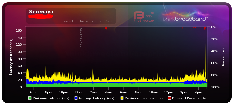

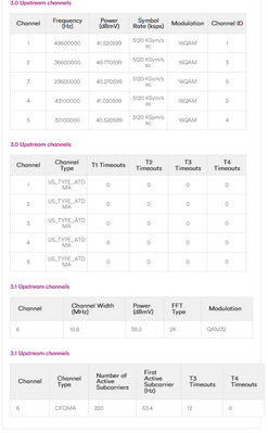

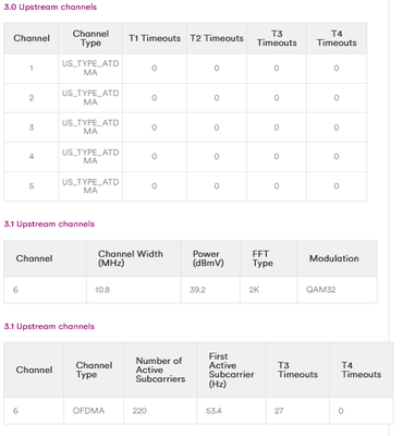

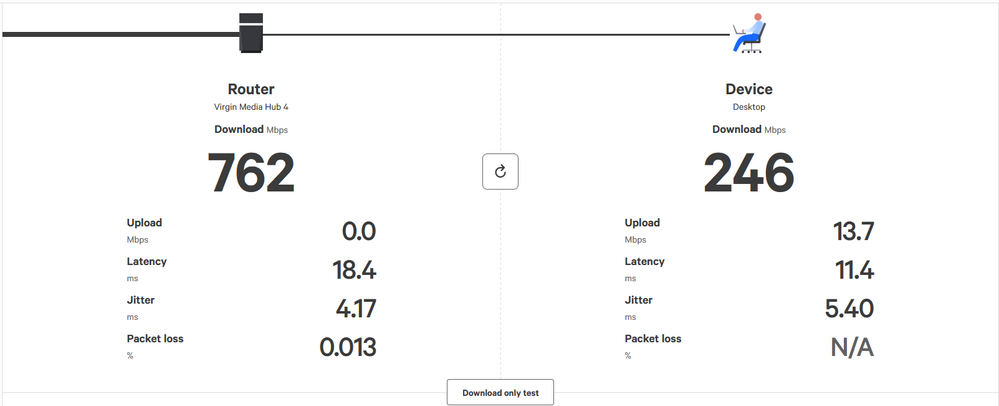

Below is an example of the effect it's having via OBS, a SamKnows test during a drop, and the BQM up until around 5pm today where I reset the router (denoted by the long red line). Current BQM is slow but sort of working. Of course, upstream router status also included. Can include downstream too if needed.
The only saving grace right now is that there is reportedly a TV-related issue in my area. However I don't know if that means that broadband is also acting up. It doesn't say so, but TV's require internet so who knows. Hopefully it's that, I guess. https://www.thinkbroadband.com/broadband/monitoring/quality/share/15c159f4b7fdddf9dbc370d1b974c0c031c67852-05-09-2023 - Here's the current BQM at time of posting.
