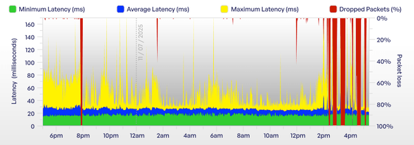

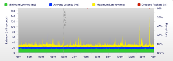

I’ve also monitored performance using ThinkBroadband BQM and observed clear packet loss and latency spikes aligning with the modem errors.
