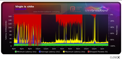

  • https://www.thinkbroadband.com/broadband/monitoring/quality/share/9eb611ea5a248fa356233a924176b102134a5d29

    Looking at your BQM at 12am - 3am all was fine so maybe someone in the area DIY a cable extension with their hub on a timer?

      Yep, I noticed that at the time. My test yesterday of pinging apple 100 times was 0% loss, and I went to bed thinking id be working normally today. But my service is now poor again. I still need mod help please.
  • Since approx 09:30, it's been reasonably okay. A few drops seeming to creep in, in the last few mins. As I've not been monitoring, I dont know whats normal for this connection. My blunt instrument of pinging apple.com from the command line 100 times yielded 1% loss. I'd still like this investigated please, god help me, this service is my livelihood.
  • Hiya, 24 hours and it's looking a heck of a lot better....
    However, I would really appreciate some VM Moderator help still. Was this an area fault that's been rectified? If not, how can we ensure this doesn't happen again?
