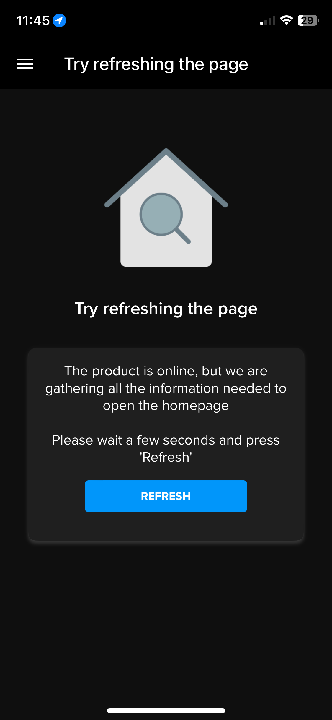

Anyone got issues with their smart heating controls? The wall units hold the wifi but the app on my phone keeps losing connection and error messages appear on my phone screen -  anyone experienced similar? TIA.

  • The controllers on the wall are connected. Using the app it connects but as soon as the heating is put on and left for eg 5 mins, the app loses its connection to the smart controls on the wall so you have to manually turn off the heating...
    We've tried different Apple phones, iPad, and our engineer has had the same problem on android. We have an extremely strong wifi signal and no issue with any other wifi enabled devices. The manufacturer has said that they've not heard of any issues with Virgin (noting that there are issues reported with Sky wifi).
    Note the comment  "The product is online"
    The device is connected and contactable but taking time to respond.
    As similar issues have been reported via Sky internet, is this behaviour the norm ?

      Right so went onto the connect app and disabled the smart security settings and BINGO I can now control my heating....
      thank you for your help!
