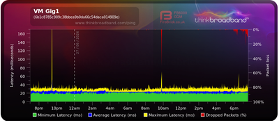

Hi all,
Hoping I can get some help here as I have tried to use the online service checker and keep getting sent round in circles with rebooting the hub / factory resetting which hasn't resolved the issue.
We have recently moved into this house a couple months back and since the install been receiving on and off issues with the stability of the network which is affecting working from home and online gaming. It will be fine for a few days then we will start seeing dropped packets / packet burst in gaming. When working from home this also kicks off the remote desktop sessions I use.
Since this has started getting more frequent I have set up a BQM graph and hopefully the links below will work:
26th:
https://www.thinkbroadband.com/broadband/monitoring/quality/share/8e0e268fee776ef7500c7d2376ceba20625b96c8-26-06-2024
27th:
https://www.thinkbroadband.com/broadband/monitoring/quality/share/a47b50c4e9688abef5cf89e9bb5f36567846ca82-27-06-2024
Also logs from the hub - I have been keeping an eye on the number of timeouts and this seems to have reset recently as a couple days ago looked like this:
If you need any more information let me know! Thanks.

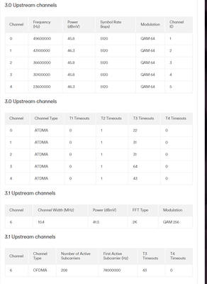

3.0 Upstream channels
04960000045.35120QAM 641
14310000045.85120QAM 642
23660000045.55120QAM 643
33010000045.55120QAM 644
423600000465120QAM 645
0ATDMA0000
1ATDMA0000
2ATDMA0000
3ATDMA0060
4ATDMA0000
3.1 Upstream channels
610.441.02KQAM 256
6OFDMA20874000000180

    Tonight is particularly bad and upload speeds have slowed to a crawl:
    04960000044.85120QAM 161
    14310000045.85120QAM 162
    23660000045.35120QAM 163
    33010000045.35120QAM 164
    423600000465120QAM 165
    0ATDMA0010
    1ATDMA0010
    2ATDMA0010
    3ATDMA0070
    4ATDMA0020
    610.441.02KQAM 256
    BQM:
        0ATDMA0030
        1ATDMA0020
        2ATDMA0020
        3ATDMA0070
        4ATDMA0030
        610.441.02KQAM 256
    • Sandman261's avatar
      Sandman261
      Thanks for the info - no faults reported on that number when I called.
      I can't seem to run that speed test as it says it's not available on my network.
