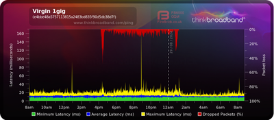

Been getting terrible packet loss mostly in evenings last 6-10h then goes away. Coincides with poor upload speed ~1mbps (normally 100mbps) and upload modulation goes to 16, so indicative of noise on line. Here is the BQM Virgin 1gig BQM
Any ideas what’s causing it? Almost like something is being switched on and off…the tines and durations do vary a bit, thought it was temperature related but think that was a red herring as issue does not revert as temperature drops in evening.

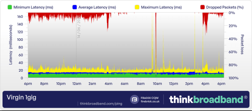

      Today's BQM, situation needs to be resolved, connection pretty useless when the problems kick in
