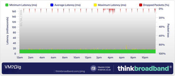

Packet loss issues 2Gig
This is infuriating, any ideas what’s been causing this random packet loss?
im on 2Gig up and down, Hub 5x

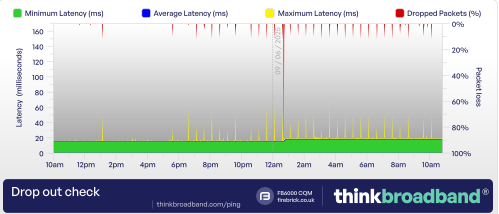

  • Exactly the same boat. 2gig up and down.
    this monitor has been running since friday, issues have been present about a week prior to that and still persist. £90 a month for constant drop outs is not the service i intended on paying for!

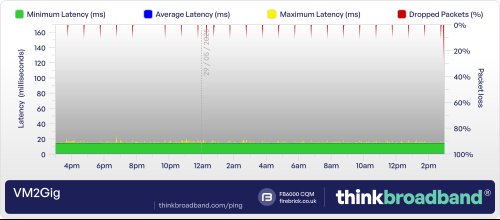

      Any luck?! I’ve got virgin mod in DMs telling me they can’t deactivate the hourly tests 😂 despite many saying they can and do! I’m still having them every hour! It’s so frustrating when I’m trying to watch a film and :45 to the hour it stops the film!

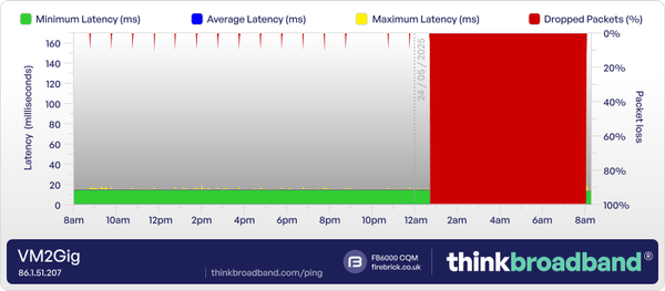

    So the weirdest thing last night between 12-1am the internet went down, the hub said the connection was okay, however it was down until I restarted it this morning then it came back on. So weird…
    There have been other reports of the hourly tests o XGS-PON.  Could this be similar?

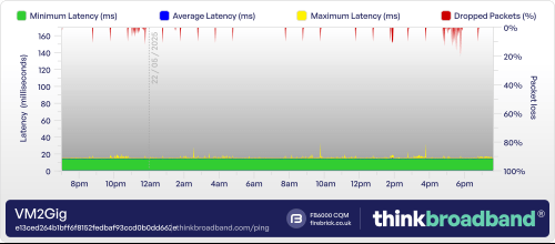

    Unused connection all day, however it only shows on real speed samknows when doing the router side of the test, device doesn’t cause any packet loss on pingplotter
