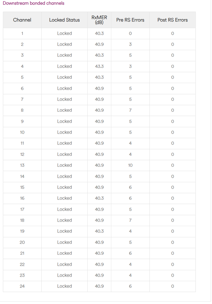

Hi there,
2 months ago, acquired a 'new' or possibly refurbished virgin media hub due to our old one basically on its last legs, since then no issues until yesterday.
Out of no where, net cut out and recognized the dreaded wifi light flickering, which i have encountered with previous hubs.
This happened also an hour ago and I'm now dreading this is going to be continuous again.
I know the cause of the hub doing this kernal / oops panic is the internal CPU restarting and also overloaded.
My question is, why is this happening and what is possibly causing this after only 2 months?  for a CPU to be getting overloaded that quickly?
please find attached,  the network logs and  also downstream  pre rs errors and post (the pre rs errors seem to show a few on different channels)
Network log -----
26/09/2024 20:39:35 critical TLV-11 - Failed to set duplicate elements;CM-MAC=**********************;CMTS-MAC=**********************:ad;CM-QOS=1.1;CM-VER=3.0;
26/09/2024 20:36:2 notice NOTICE ATOM is restarted due to Kernel/oops panic as part of Self Healing Mechanism ;CM-MAC=**********************;CMTS-MAC=**********************:ad;CM-QOS=1.1;CM-VER=3.0;

---downstream printscreen could not copy and paste results----

  • Update, decided to see if readjusting the co-axle cable would do any good and see if issues decreased and or performance improved,  Will still be contacting virgin after keeping a close monitor on the situation.
    Try to Copy / Paste the text of the the Hub signal levels , that can work better than a screen shot.
    Reports of the Intel ATOM CPU errors were common years ago, a Hub replacement may be the only option.
