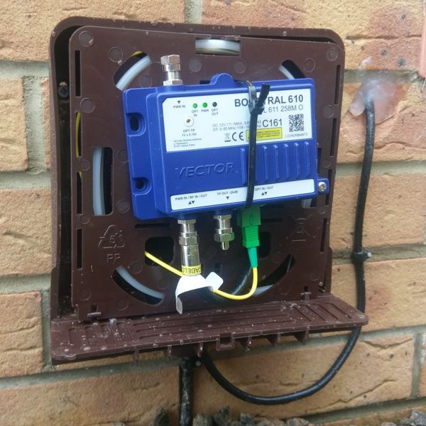

  • DJ1UK's avatar
    DJ1UK
    Engineer replaced the blue box in the box outside and checked all connections.  I'll continue to monitor though the logs already show the Atom error this evening.
    I'll get back in touch if it keeps disconnecting daily.
    That reads like the ONT was replaced in an RFoG connection.
    We have the same system, here is an example photo:
    • DJ1UK's avatar
      DJ1UK
      Yes replaced the whole blue box part and checked everything, I thought it was called ONT but wasn't sure :)
      Still got the Atom failure message and wifi drop around 8pm last night, will leave it a few days to see if it repeats once or twice a day then get in touch again to book another engineer.
