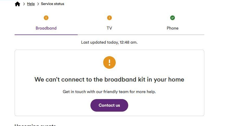

      Using the virgin media service status, it shows
      but you cant contact anyone as they are not working at night, even in India where all my calls to customer service end up, it seems. I have used the online thing, but this just gets to a point where it briefly flashes 'call a human' and then dissapears.

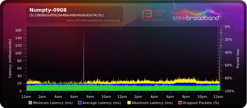

        Well, its happened again tonight. Best part of a month after the problem 'went away' .. its back. Same as before, samKnows and ThinkBroadband dont report issues as long as I connect via the guest network, using the main network (cable or wireless) gives no internet connection at all. I can view other devices on the main network within my home, apart from the router itself (192.168.0.1) which times out.
        Slow speed is due to the card in the laptop, its old.

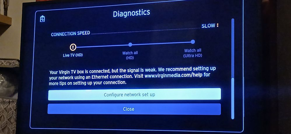

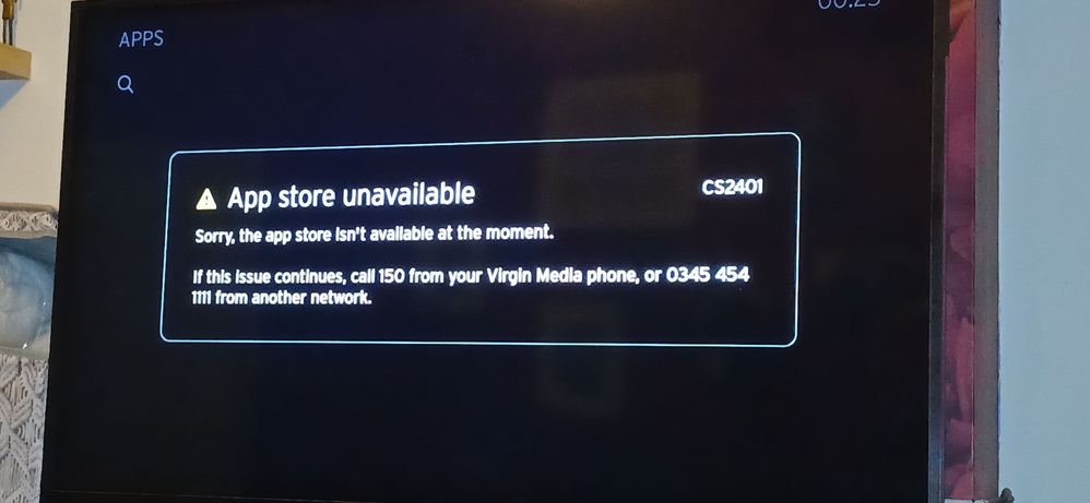

    and again, 24 hours later the home network drops and I loose ethernet, wifi, streaming services .. even the home screen of 360 is a bird holding a wire as it cant load all of the bumph that appears normally.

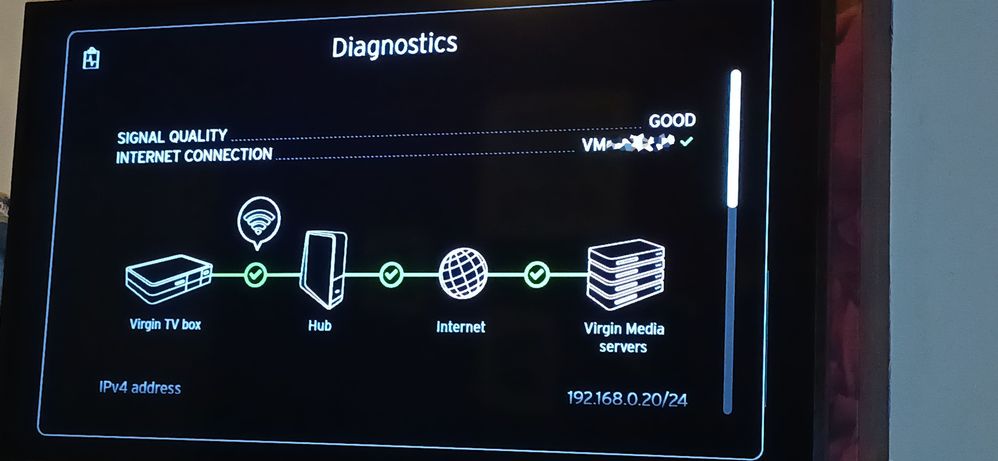

    Did a test of the connection within the settings of 360 and got this:
    ..so it can see the virgin server apparently, but there is no speed.
    However, trying to use 360 gives:
    ... so it cant talk to virgin, but it just said it could. This is the insanity I am having every night of this last week at around 00.20 (give or take a few minutes as sometimes I dont spot its dropped straight away). Same as written about on the computers, anything on the 192.168.0.xxx network, nothing can talk to the net and the router (192.168.0.1) is unreachable to connect to .. but I can connect to other devices on that subnet (for example, a device at 192.168.0.6 connects straight away).

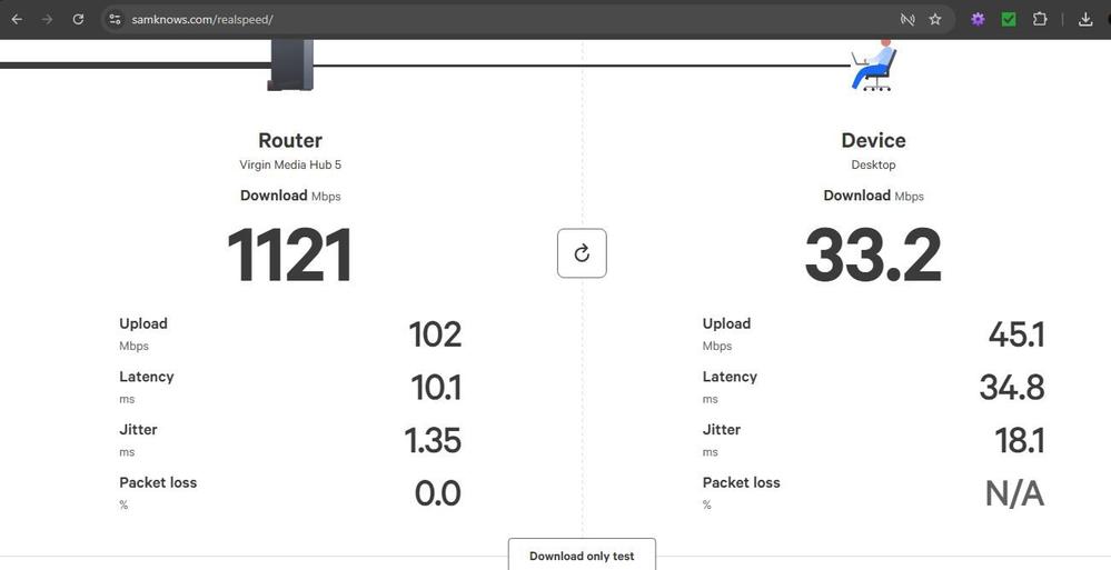

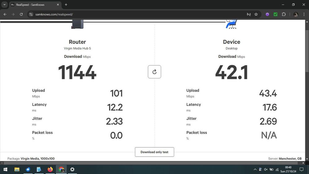

    Change to use the guest network (192.168.1.xxx) ... and its working fine. Here is a screen grab of a samknows test done just after the above were taken of the tv:
