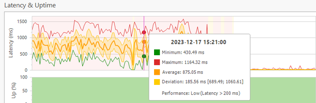

Hey everyone, for the last few months we have been having very high packet loss and latency spikes (ranging from only a few seconds to a few hours at a time). For a quick example here is the connection today to OpenDNS. With average latency of around 900ms during the window (the graph is for 3 hours).
Before and after will be okay with latency of between 10 and 21ms. Local traffic is completely fine. The box is a SuperHub 3 and has been running in Modem Mode for years.
I have been trying everything and speaking to Virgin Media but as the issue is intermittent they are not interested in investigating. One final thought I have is that it might be related to power levels. I don't really know anything but I feel the T3 timeouts look a bit high. What do people think? This was also during a period of the connection working, will try and capture it during a spike next time. Also, thank you so much for any time you spent on this. It has been driving me insane.

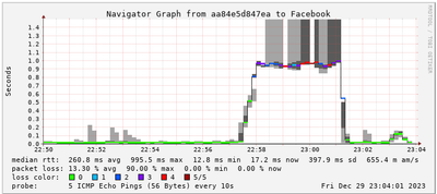

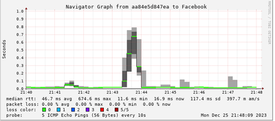

    However I have had the opportunity to set up a more complete testing suite on our side and after analysing some local traffic I can replicate the latency spike. Here is an example of a persistent latency issue that we saw above.
    And here is a triggered latency issue for a few minutes:

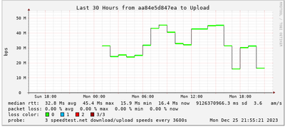

    The latter of which occurred while continuously uploading to the internet (I have tested this locally and there is no latency impact when copying to/from a local server at 350Mbps).
    After which I can across this buffer bloat test showing just how extreme the increase in latency is while uploading:
    https://www.waveform.com/tools/bufferbloat?test-id=52c72849-475c-406f-bca6-35f4b779493c
    We are on the M500 package (so in theory 52Mbps upload) but something we see only on occasion.
    In theory SQM (which we have and is "automagically" enabled) should help but with such varying bandwidth it seems pretty difficult to solve. Maybe something like `autorate-ingress` in openwrt would help but this is definitely a plaster to cover a bigger upstream problem.

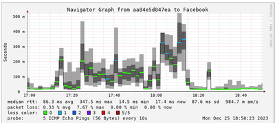

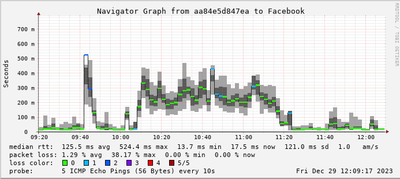

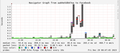

        Just coming back to share some additional latency graphs from today which has had two particular bad periods (during which time there was limited local traffic on the network). The below graphs are for Facebook but true for any outbound traffic.
        Also would encourage anyone who is facing similar issues to use SmokePing for long term monitoring (with a very low polling time, we are using 3 pings every minute).
  • Testing over the weekend and it does look like there is something happening on the hub occasionally which causes periods of slow packet processing and/or packets drops.
    It looks similar to this issue where a hub replacement solved the issue: https://community.virginmedia.com/t5/Networking-and-WiFi/Hub3-in-modem-mode-ping-spikes-and-packet-loss/td-p/5384022/page/2
    However the good news it that whenever latency to the modem increases, it can just be restarted and it will be okay until the process on the SuperHub 3 starts again (and then it is just a reboot away from being okay). This is frustrating but at least there is a workable solution in the meantime.
