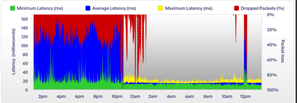

  • BQM link https://www.thinkbroadband.com/broadband/monitoring/quality/share/8764c72365c6a634e2f7524c8789bd74bc5a6b8d
    Regards service status, I usually check this when I have issues and nothing is reported for my area. So the problem looks to be specific to my service.
    I live alone so no one else is using the service and I periodically check for rogue devices.
    The problem is very intermittent, it could be fine for 1-2 weeks now, then I'll suddenly get a couple of days when it's bad again, which is why it's so hard to get any traction with VM.

    If it was a faulty hub I would think the problem would be non stop on going but 2am -10am looks fine.
    Might be a fault out side with the Docsis link?
    Went the connection is good post your downstream and upstream from the hub then when it goes bad post again.
    Post the live link of the BQM.
