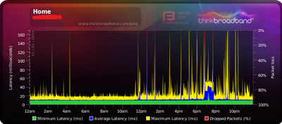

  • Here is some quality monitoring for one of the days. I don't leave it on all the time for security reasons.
    Best log a fault with VM then?
