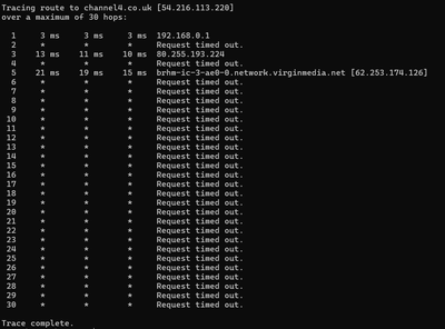

I have also tried Tracer Route to both channel 4 and U TV websites results attached. Both traces show Requests timed out on hops 3 and 5 which if, I am understanding correctly, are within the virgin network. Could these time outs be a part of or indicator of the reason for these drop outs?

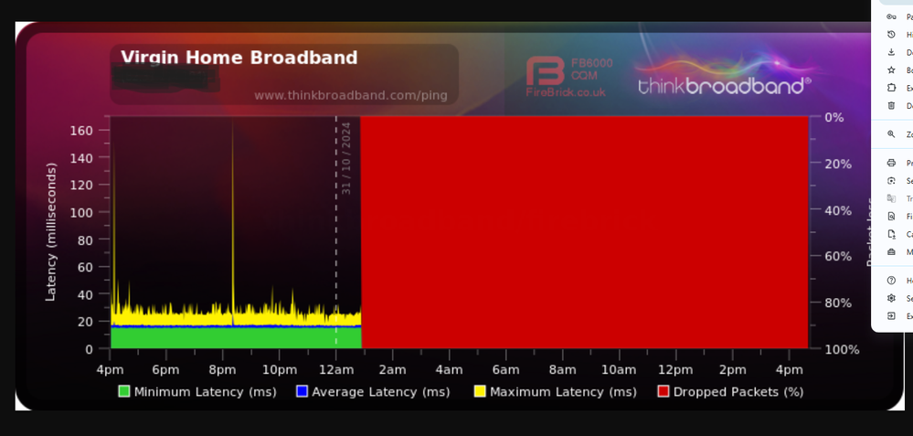

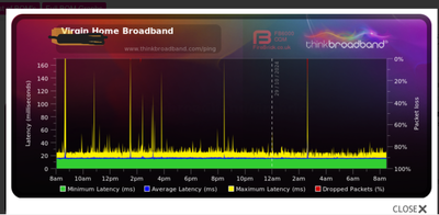

    US power is right at the  top of the spec, so could be lowered.  The BQM has some packet loss showing with the red "fringing", but very small in fairness.  As for Channel 4, I get the same results with tracert and ping to both C4 servers.  This would suggest the router ignores ICMP requests for security reasons.
    • DA65's avatar
      DA65
      Thanks Adduxi.
      This is BQm today at 12:30. Internet seems to be working ok Router status shows no fault warning since 00:13:10 this morning.
      Does this show that test signal ping is losing packages but other internet packages are getting through?

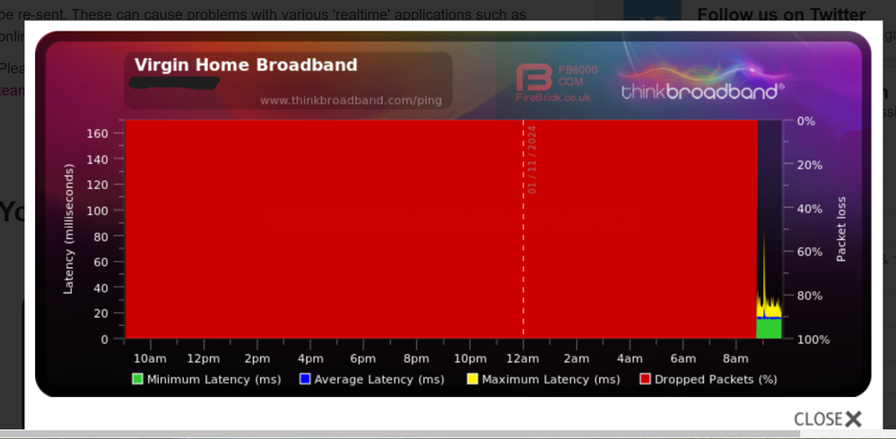

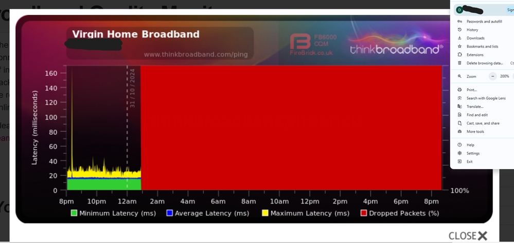

    Following my earlier post on Tuesday the problems continue and have been particularly frequent over the last two evenings .
    The following BQM outputs show the situation yesterday and today before and following a router restart

      Yup upstream power levels look high to me and downstream are also a bit low. Check for local faults on 0800 561 0061 otherwise call it in as a fault on 0345 454 1111 / 150.
      The BQM indicates there was a total loss of service from 1am to 9am the following day.
      Yet there is not a single word about this in the original post.
      What is the BQM pointing to ?   A generic VPN exit point perhaps ?
      • DA65's avatar
        DA65
        Sorry I did mention in second post that despite BQM showing 100% packet loss internet was working fine but post exceeded word count and this was lost.  BQM points to IP address shown by BQM What is my ip address tool.
    • Sephiroth's avatar
      Sephiroth
      … Or the public IP address has changed and the BQM is thus no longer in contact with the hub.
