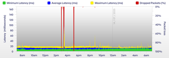

Here you can see how these drops look:

    Thank you! The tech came today, said the same, and connected an attenuator. Will be observing the signal now, hopefully the drops won't come back.
    Your US power is too high and there is noise on the line as shown by the PostRS errors.  So a VM tech will need to sort that out for you.  It could also be a local area fault in which case no tech will be sent until this is resolved.  Try checking with Area faults on  0800 561 0061 or if you have a VM landline 150 as small local faults are not listed on the VM status page.
