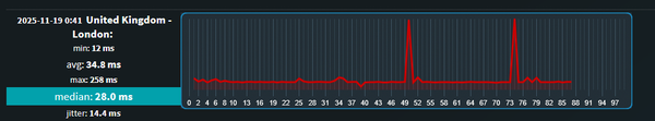

Huge Latency Spikes Every Few Seconds
Hello, since September I have had an issue of huge latency/ping spikes every few seconds. My internet speed is just fine, but these spikes in ping make it borderline impossible to play online games.
This occurs on all devices, regardless of whether they're using WiFi or Ethernet, these spikes do not appear when pinging my default gateway (they are not related to any devices' connection to the router itself). No engineers I have had out have managed to fix the issue. I have been looking over the internet for a solution for a while now and haven't found one. I am not sure what else to do at this point.

    I am consistently getting massive amounts of packet loss on my router, and am also getting T3 errors on the upstream channels.

        I had an engineer out a few days ago, he agreed that there was a problem on the upstream channels. He replaced the router and did some other things, though nothing fixed the issue. He said that another team would be out to look at the area's network in a few days, because it is almost certainly an issue with Virgin Media in my area - though it is now Friday night three days later and the internet is still very poor in quality. This problem has persisted since early September now, and it's difficult to see it being fixed anytime soon. I might just have to switch providers, unfortunately.
