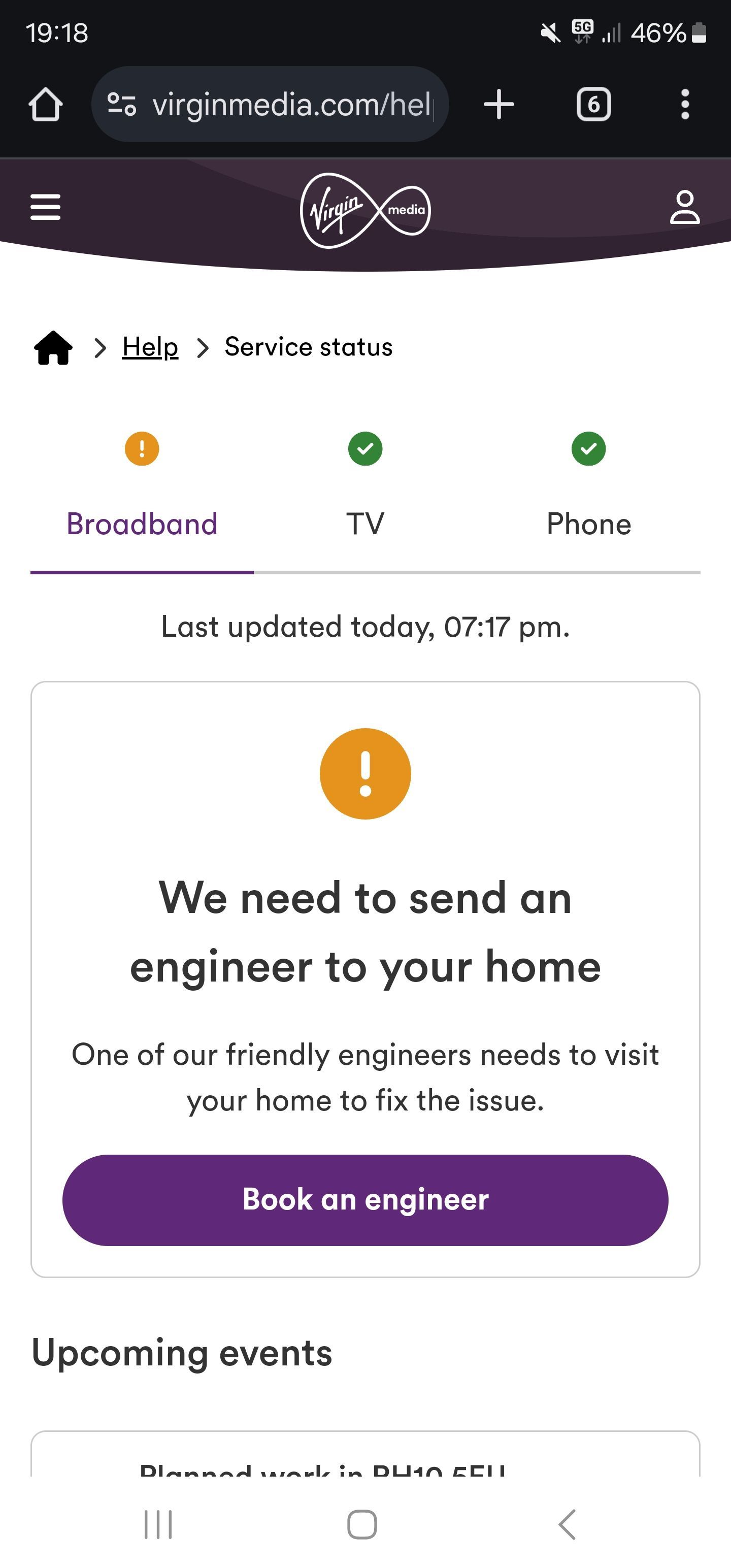

Did an online check on the virgin website and it instantly said an engineer needed to visit.

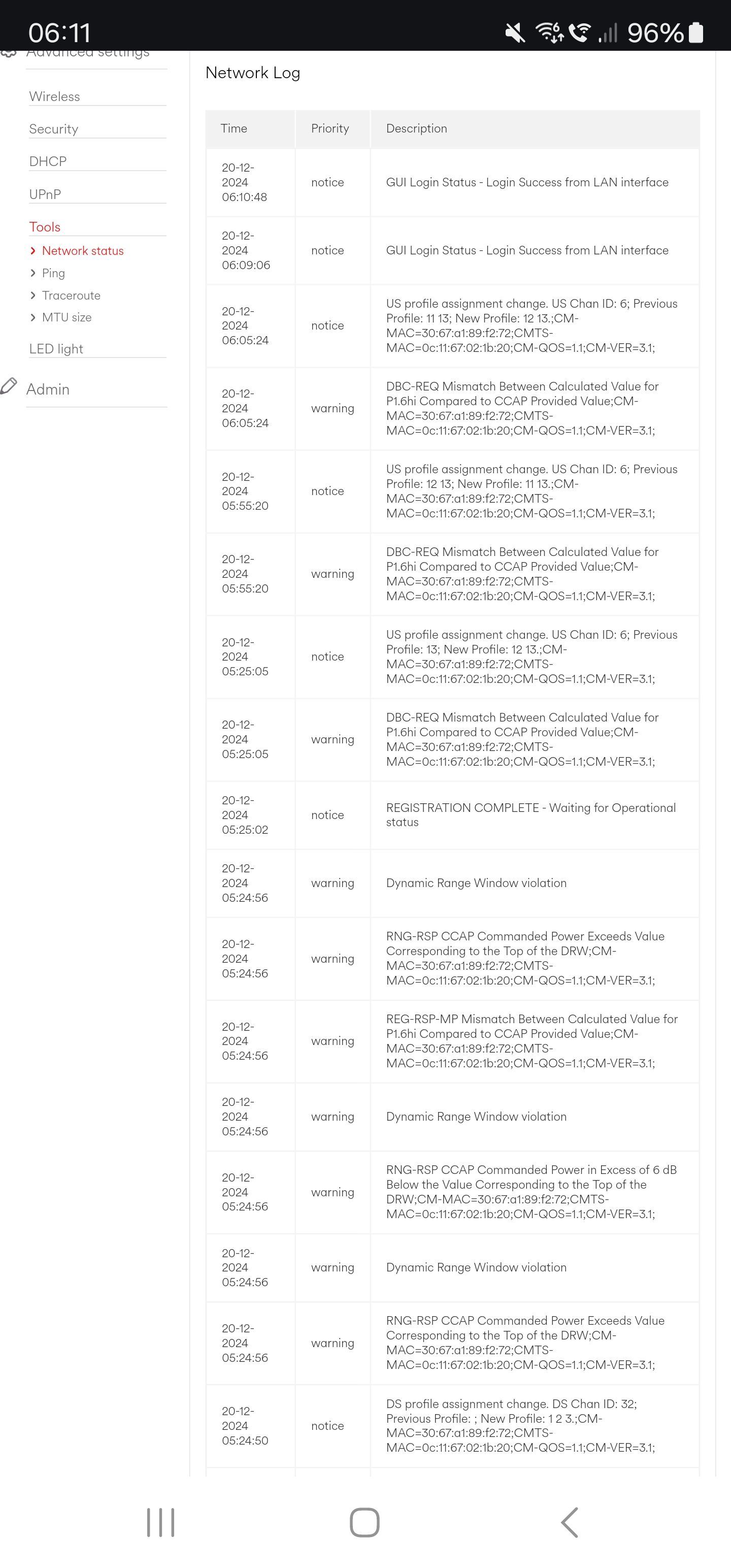

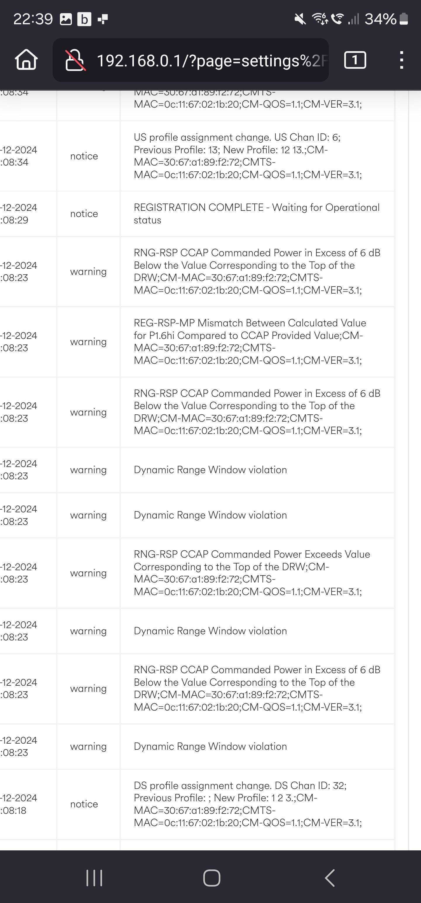

I have a few issues according to the router logs, but unsure if they can tell a story?
18-12-2024 05:48:17noticeGUI Login Status - Login Success from LAN interface18-12-2024 03:20:57warningDBC-REQ Mismatch Between Calculated Value for P1.6hi Compared to CCAP Provided Value;CM-MAC=**:**:**:**:**:**;CMTS-MAC=**:**:**:**:**:**;CM-QOS=1.1;CM-VER=3.1;18-12-2024 03:20:57noticeUS profile assignment change. US Chan ID: 6; Previous Profile: 12 13; New Profile: 11 13.;CM-MAC=**:**:**:**:**:**;CMTS-MAC=**:**:**:**:**:**;CM-QOS=1.1;CM-VER=3.1;18-12-2024 03:10:52noticeUS profile assignment change. US Chan ID: 6; Previous Profile: 11 13; New Profile: 12 13.;CM-MAC=**:**:**:**:**:**;CMTS-MAC=**:**:**:**:**:**;CM-QOS=1.1;CM-VER=3.1;18-12-2024 03:10:52warningDBC-REQ Mismatch Between Calculated Value for P1.6hi Compared to CCAP Provided Value;CM-MAC=**:**:**:**:**:**;CMTS-MAC=**:**:**:**:**:**;CM-QOS=1.1;CM-VER=3.1;18-12-2024 02:40:34warningDBC-REQ Mismatch Between Calculated Value for P1.6hi Compared to CCAP Provided Value;CM-MAC=**:**:**:**:**:**;CMTS-MAC=**:**:**:**:**:**;CM-QOS=1.1;CM-VER=3.1;18-12-2024 02:40:34noticeUS profile assignment change. US Chan ID: 6; Previous Profile: 12 13; New Profile: 11 13.;CM-MAC=**:**:**:**:**:**;CMTS-MAC=**:**:**:**:**:**;CM-QOS=1.1;CM-VER=3.1;18-12-2024 02:30:30warningDBC-REQ Mismatch Between Calculated Value for P1.6hi Compared to CCAP Provided Value;CM-MAC=**:**:**:**:**:**;CMTS-MAC=**:**:**:**:**:**;CM-QOS=1.1;CM-VER=3.1;18-12-2024 02:30:30noticeUS profile assignment change. US Chan ID: 6; Previous Profile: 11 13; New Profile: 12 13.;CM-MAC=**:**:**:**:**:**;CMTS-MAC=**:**:**:**:**:**;CM-QOS=1.1;CM-VER=3.1;18-12-2024 01:19:50warningDBC-REQ Mismatch Between Calculated Value for P1.6hi Compared to CCAP Provided Value
After last night's issues I have some new errors, which are hopefully in the attached image:
Dynamic Range violation
Commanded power in excess of 6db

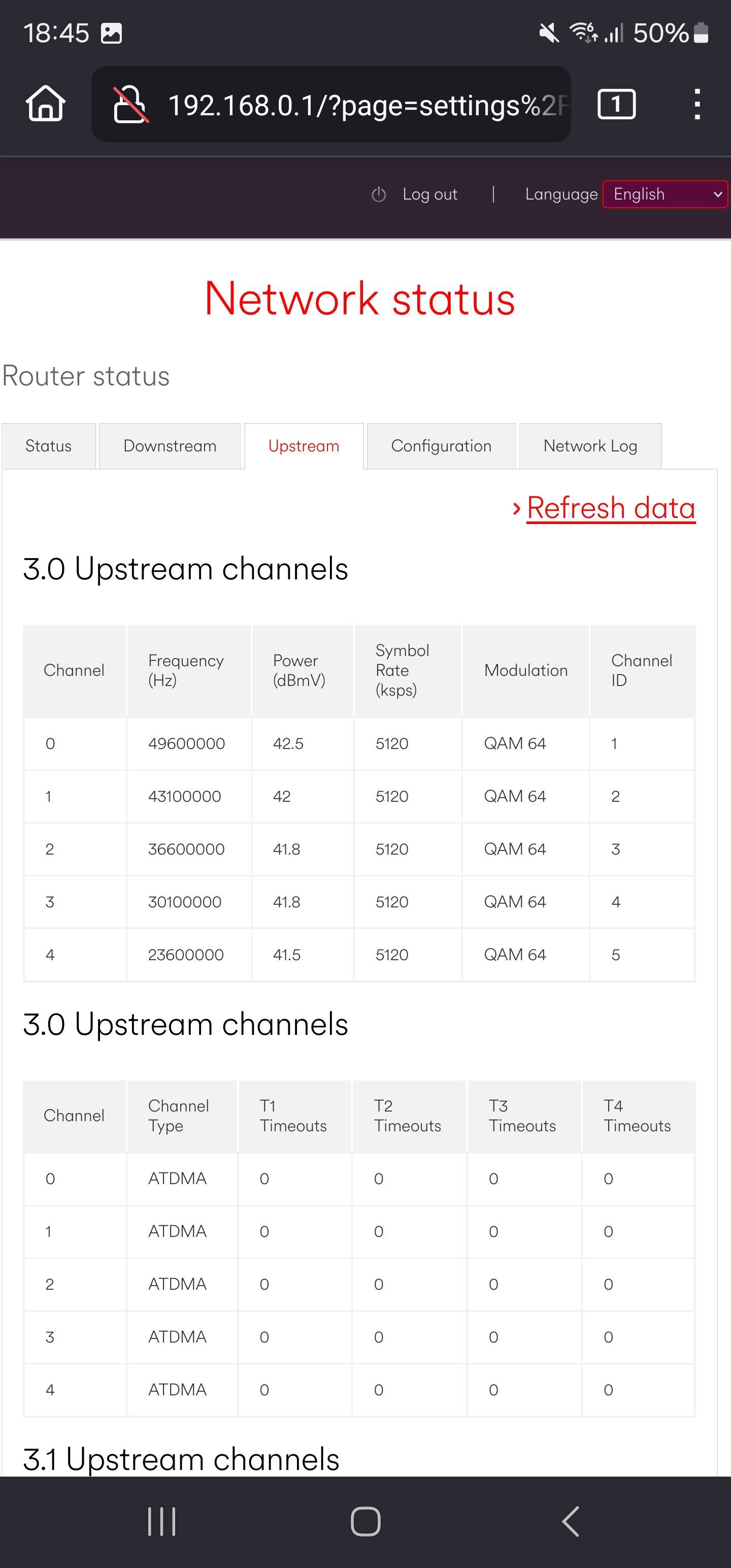

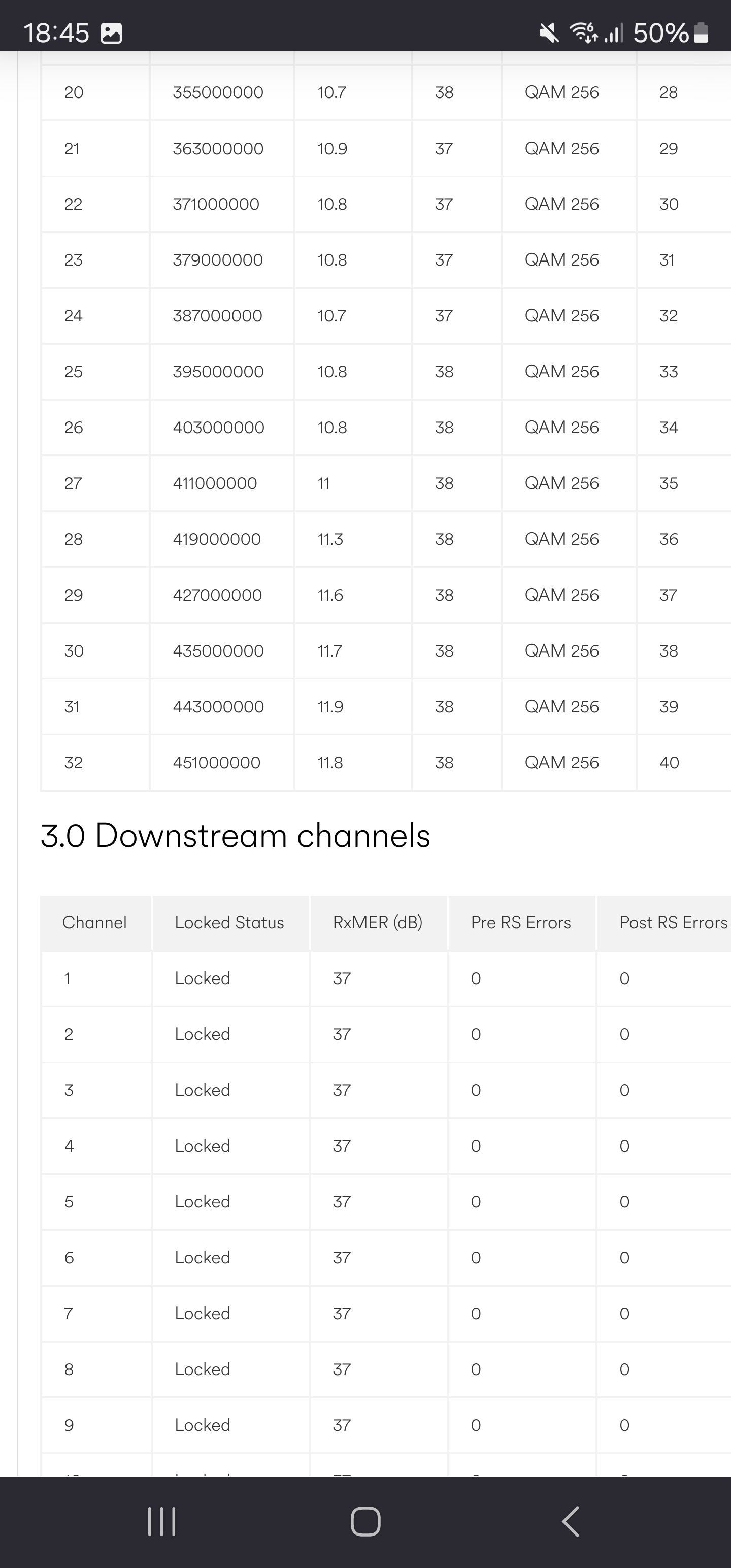

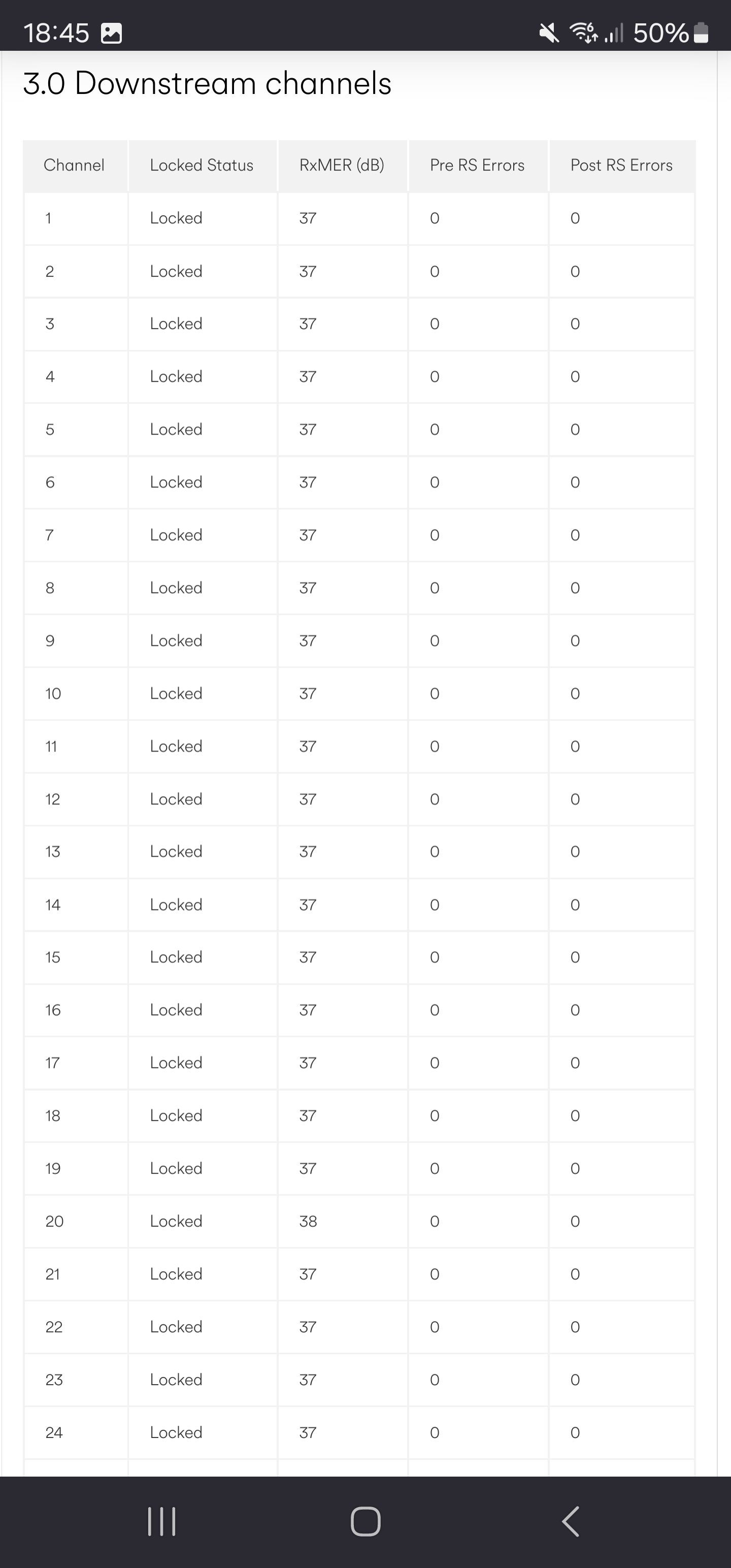

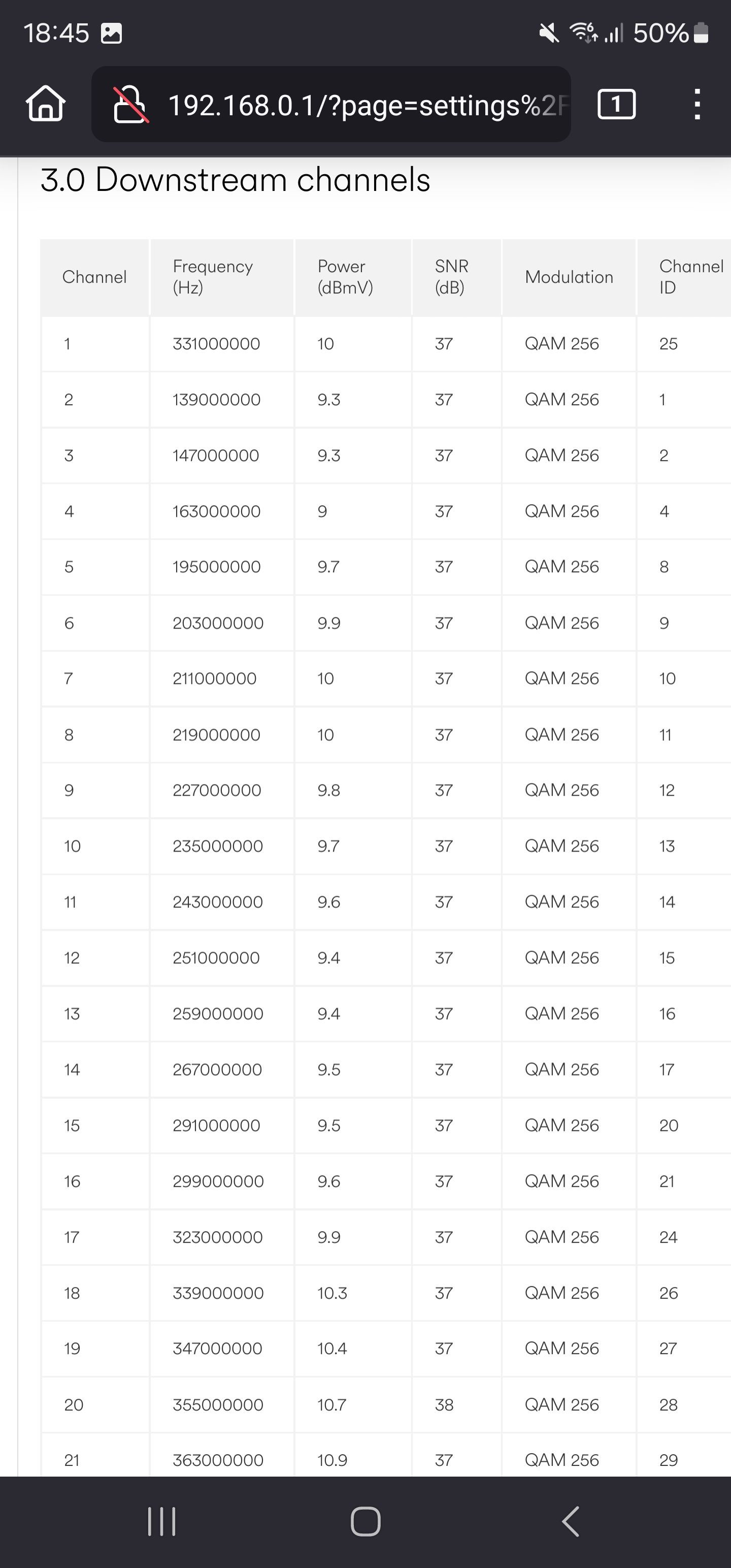

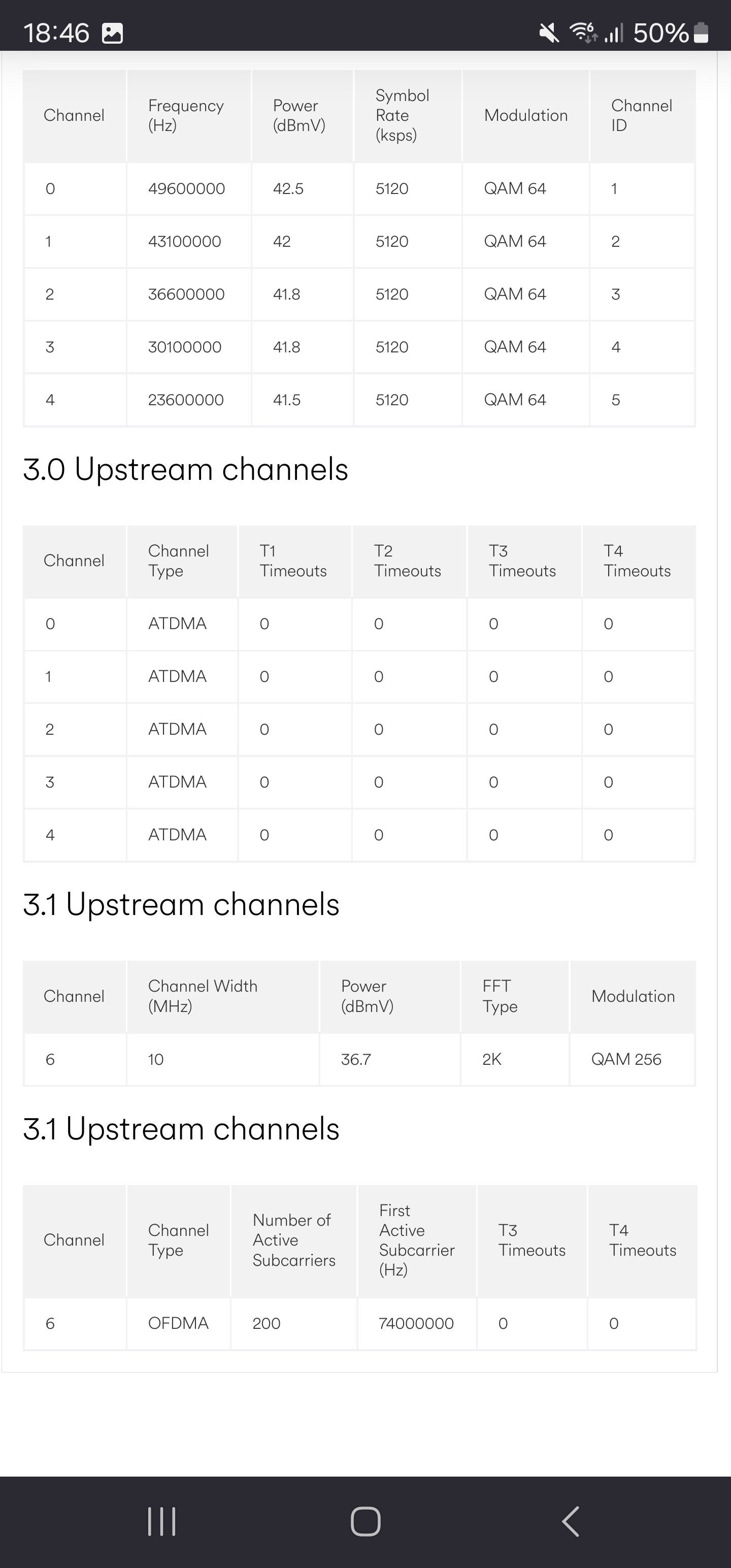

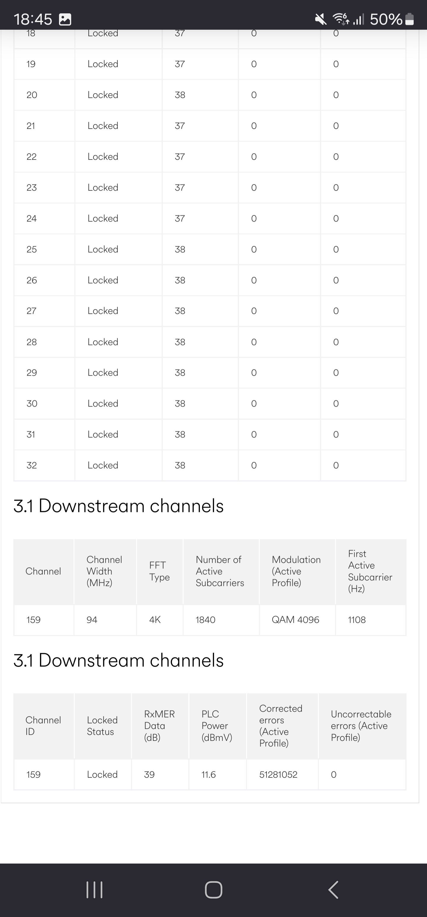

    Could you copy / paste the text from the Hub's Downstream & Upstream status tabs,
    this is where we see the signal to the Hub and perhaps the reason for needing an engineer visit.

    Downstream power levels are all very high & too high level ( 10 dBmV is the usual maximum ).
