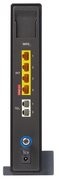

    The Hub 5 has a WPS button on the rear it can be seen above the network sockets,
    and WPS set up is present in the Hub 5 admin menus.

  • I feel like a complete idiot, because WPS no longer on the front I assumed it was no longer required. Problem solved, money saved. Guess I just got caught in a loop and assumed the printer was old (like me) and more or less redundant. Many thanks for the advice much appreciated. Regards, John
