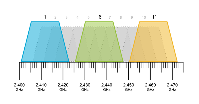

    On the 2.4 GHz band is it best practice to use channels 1 or 6 or 11 only, using other channels causes overlap interference.  Below is a graph of the 2.4GHz band using Ch 1,6,11.
    As you can see, selecting channel 3 or 8 would not be a wise move.
