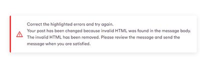

    @Matthew_ML I can't message you back with details because every time I try I get this nonsense even when my message is just text:
    It's incredibly broken no matter what I try to send a reply.
