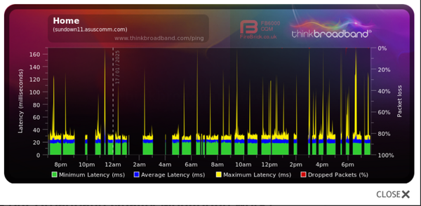

In the last couple of weeks I have been suffering from intermittent packet loss. To fix this I have had to reboot the VM Hub to set it back to a usable mode. It happened again this morning .. this time I had ThinkBand BQM in place and the following graph indicates the problem.
https://www.thinkbroadband.com/broadband/monitoring/quality/share/3289cb13cab3443ca0efc8c0ee92670a381c3810-06-01-2025
Is there a problem in my area (EH12 8UA) ir does the VM hub need replaced?

    I really need some assistance from a Virgin Media Engineer.. todays BQM is terrible. Yesterday I rebooted my router as speed test was low , on startup my router couldnt get an IP from VM. That lasted 2 hours before it came back. I dont know what to attempt now.

      Those stats from 3 days ago are horrendous, you definitely need a technician’s visit. Best to phone in:

  • I have never EVER seen gaps like that in a BQM graph before, I thought if it couldn't contact it was just blocks of red but I have never seen actual gaps in the data before.
    Absolutely no idea what on earth is going on there but hope you get it sorted.

    The Engineer was here yesterday and check all cabling etc. All seemed good. He replaced the hub5 and  today things look like they should so I am happy (for now anyway) !
