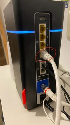

Hi, I have a Gig1 fibre hub. I want to connect my PC (running Windows 11) to it via an ethernet cable in the wall socket, but it seems that I get no ethernet when using the wall sockets, as when I check ethernet settings it is not connected. I also have a brand-new ethernet adapter plugged into one of the USB C slots. I know the adaptor isn't the problem as when I connect my adaptor directly to one of the router's ethernet ports it works.
I tried connecting the router to one of the wall sockets next to it which I assume is the central distribution point that supplies all the wall sockets with the ethernet, but that doesn't give me anything, tried changing the ethernet cables and that does nothing; I'm having trouble finding the ethernet switch.
Coloured red is what i have connected the cable to now, and it is the only place that i can to my knowledge. I acc dont know whether it is functional or from virgin media.
The third image is the thing my router is connected to but there is no ethernet slot.

    Virginmedia don't do ethernet wiring. Your pictures don't show a VM device, so this was done by a previous owner or electrician. Hopefully the suggested tool will assist you in tracing the connection.

      the second picture image shows the socket (to which I connected the router to) that I assumed was the source As it was located in that utility cabinet/ area where my wifi was set up.
      As those cables are behind the wall I’d have a hard time tracing them to the source; if you could point me in the right direction as to how I could track them, it would be much appreciated
