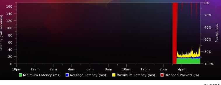

Not sure if anyone else is seeing this, but today i have been encountering packet loss. Normally this would be ok but when streaming TV, or gaming this cuts out the connection. I have run BQM for 2 hours (i know thats not a long time) this happened a few weeks back but Virgin said it was a fault in the area. I have checked the service status page and its not saying any outages in my area.

      Hi, an engineer came out yesterday and said that the upstream power levels were borderline. So hes tweaked these a bit and replaced the super hub but i am still seeing the same high levels of packet loss.
      https://www.thinkbroadband.com/broadband/monitoring/quality/share/ecb37d8ce8d1365cd847083b78d26f7de88d77fb
      I have also set BQM running on a family members system and that is not getting anywhere near this amount of packet loss.
      The engineer that came said they dont test packet loss, latency or anything like that but the issues are still happening?

      Hi,
      Thanks for replying, i have run the ping and noticed that it drops out at the time when the BQM show packet loss. I have also run a reoccurring ping to the internet and to a local device on the network. The internet one drops out again when the BQM shows packet loss but the local one doesnt. I have the router set up in modem mode and plugged into an Asus router, but it still does the same when i take it out and put the SH4 back into router mode.
      Another engineer came out Thurs and swapped the attenuator and the cable, he again said the signal strength was ok. He said to leave it a week to settle down and if it still continues to happen to call up and ask for the cable outside to be reprovided.
  • Theres been a lot of drop outs over the last 24 hours, it stops up streaming things on ITVx and 4OD for about 30 secs then comes back on, it also drops out the connection when im playing EAFC which is a pain.
