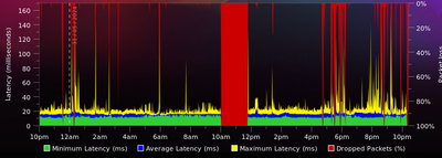

Consistent intermittent dropouts for the past year
An engineer came out to replace the router around a week ago, yet nothing has changed. I've replaced the coaxial cable since it seemed a little decrepit, again to no avail. I've looked at the router's upstream/downstream stats and they all seem to be within spec. of what I've seen from others' routers, besides the pre/post-RSS error count.
I'm genuinely just baffled at how/what/why the signal is so appalling. Whenever the internet does work I get around 300/10 Mbps. I'm not sure if it's placebo or what, but whenever I seem to do anything that could bring me happiness the Internet shuts down for about 5 minutes, if that helps.
(10-12pm is a power outage)

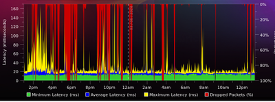

      Been monitoring it for 24h now with the old co-ax back on. It has been pretty much the same.
      6pm is when I changed the cable, I didn't record any up/downstream stats, but as of now:
