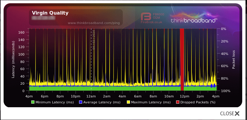

Hi Everyone,
I have an issue with my connection that I have had previously. I wasn't happy that the problem just 'went away' without anyone able to provide me with an explanation.
Basically, every 30 minutes the signal to my router stops for about 30 seconds to a minute. I know this because I have a BQM setup and can see it. I have attached the report from today.
I have tried phone and chat support, but they were both most unsuccessful because they cannot deal with anything that doesn't fit their script. I have reset my router etc. to go through their merry little dance, but the problem is not with the router or any equipment in my house it is clearly the signal coming into the house. Unfortunately, this falls on deaf ears.
I wonder whether anyone who has some technical chops at VM can help me here. I am very frustrated that no one else seems to have this issue and that there isn't a way to report this to someone knowledgeable - although that may be because this type of intermittent problem is hard to detect.
Please someone help!

      Thanks for taking the time to reply @jbrennand.
      Here are the answers to your questions
      1. I have a hub 3.0 in modem mode. Only one ethernet cable connected - to my Ubiquiti router.
      2. I checked the service status by phoning and there aren't any issues affecting my area.
      3. All cables are finger-tight. VM box on the outside wall has not been disturbed and it doesn't look like there are any loose wires or unterminated cables.
      4. The internal wiring looks good with no kinking or chaffing. Nothing has been moved.
      5. Logs to follow.

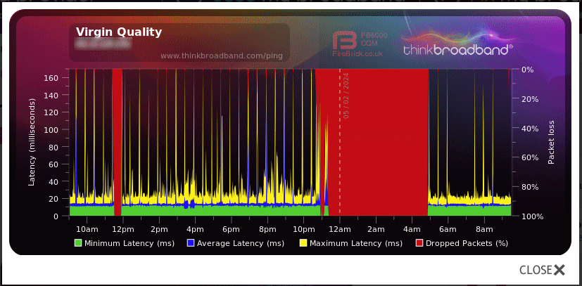

      Further info. I can see this started at 16.30 on Thursday 1 February. There was also an outage last night between 11pm and 4am, which wasn't a power cut or deliberate power cycle by us. Looks like the issue is still there.

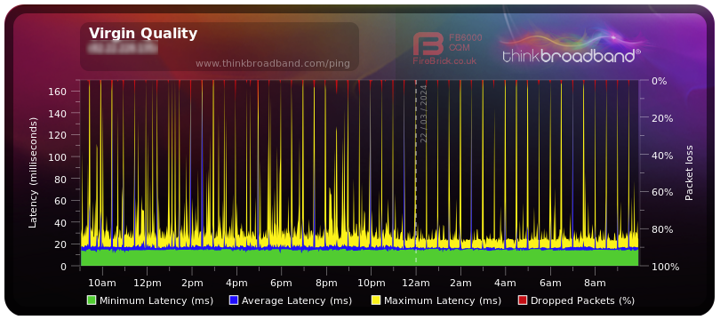

    If anyone is actually listening I could use some help. I am experiencing the exact same issue once again. It started on Tuesday 19th March around 1.30pm and is ongoing. See screenshot.
    I have done the following:
    Contacted the 0800 number and it reports no local area issues.
    Performed a factory reset
    Not sure what else to do - I can't get on the chat for some reason so I cannot report it there.
    I'd be grateful if someone from VM can pick this up swiftly.
    Andy
