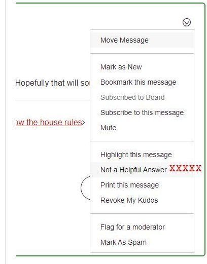

      Please can you do me a favour.  You've marked the post as a 'Helpful Answer'. The Forum then automatically shows the thread as solved, but we haven't solved your speed issue, so you need to undo that, it's easily remedied by yourself.
      Click on the dropdown menu icon in the top right hand corner of the post you marked, and in the dropdown screen click on Not a helpful answer (screenshot  at the bottom of this post)
