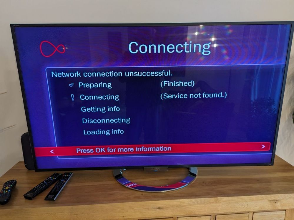

I've been away for a couple of weeks.
In that time my box has lost connection with the Virgin Media Service.   This used to happen a lot with my old box, but has never before happened with my V6 Tivo box.
I've rebooted the router and the Tivo box multiple times, but no dice.  When I try to connect the VM box it times out on the "Negotiating" stage.   See pic.
Broadband is fine.  TV is fine also, except there are no programme listings/descriptions, and recordings don't work.
Thanks

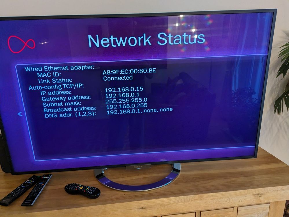

      The V6 is connected by an ethernet cable.  I'm fairly confident that this isn't the issue, as I tried disconnecting it then trying to connect to the Virgin Media Service again through the menu, and it (correctly) told me that the ethernet was disconnected.  I've also tried connecting to VM being connected to the router via WiFi instead of via ethernet - same result.
      Finally, the attached pic would appear to suggest that all is well with the box's connection to the router.

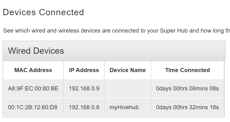

  • If you log into the router, can the router see the V6 box? If you've got a second V6 box, can that one see the V6 box that's playing up?
      This is a good point. I'd taken it as read, given that VoD works, that the 'net connection is proven. But check your router for "connected devices" and ensure the IP address matches that which the V6 displays.

      HI SpacePhoenix.   Yes, it seems to be (see screenshot).  The IP address 192.168.0.9 matches the one the box think it has from "Network Status".
        Hi ntruby

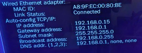

        I'm not a wifi expert but looking at your earlier posts it seems to me that the V6 isn't connecting to the  correct VM DNS (addr 1,2,3) 192.168.4.100 and 192.168.8.100
        Yours is showing as connected to DNS (addr 1,2,3) 192.168.0.1, none, none
        I can't check on a V6 as I converted to a 360, but my 360 shows the  DNS server 1 as 192.168.4.100 and DNS server 2 as 192.168.8.100

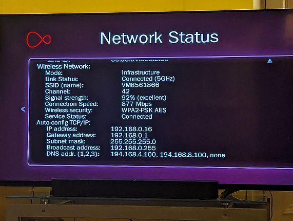

        The screenshot below is from a quick google search showing another V6's network settings.
        Is your Hivehub working correctly? I'm wondering if that set up is affecting the V6 connection
  • Roger_Gooner's avatar
    Roger_Gooner
    I was just about to post that the DNS address is wrong when you beat me to it.
    If a box doesn't have the correct DNS address it cannot resolve domain names and all sorts of problems could result, including but not limited to making it unable to access various online services, program guides, software updates and VOD.

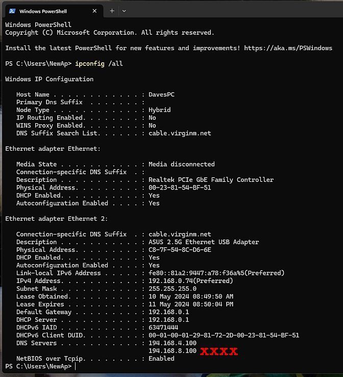

        ntruby wrote:
        I have no way of influencing the DNS settings of the box (that I know of).
        And the DNS of my laptop (from which I am typing to you) is 192.168.0.1 (the VM router) also, which is fine.
        Open a command prompt and type in ipconfig /all
        The window that opens shows your DNS servers which should be as per the screenshot below
