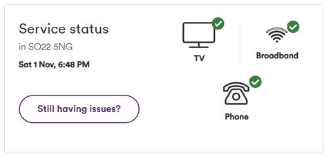

I went to the web site to see if there were any issues; when I first log in, I get the message

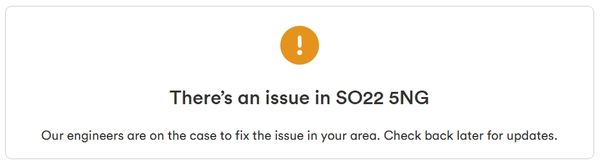

but if I press the "Still having issues?" button, I get the messages:
What on earth is going on - any ideas?
Regards,
Cliff

  • nodrogd's avatar
    nodrogd
    VM have two systems that report faults. One is a node level system that shows problems affecting down to around 500 customers (this shows on the app & website), and another system that goes down to individual cabinet level (this can be obtained by dialling 0800 561 0061 or using the diagnostics on your equipment). This fault is more than likely an SNR issue affecting the TV part of VMs distribution system. SNR interference faults are notoriously difficult to trace, & are usually the result of a customer on your local network making unauthorised modifications to VMs coaxial cabling within their property. Until the problem wiring is traced, entry to the property gained & the modification removed, issues are likely to continue.
