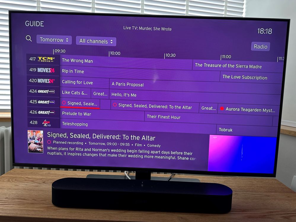

      My wife likes the movies on the Great! tv channels. We push record on the fist part of the movie and a hollow red circle automatically appears on the first part and second part of the movie, picture included for tomorrows recording. These are a series of tv movies so the system also plans to record all subsequent films which is what she wants but then always records only the first half of the film.  As previously mentioned we have tried using the advance record feature to add more time onto the end of the recording but it exactly records the advertised program length, we have also tried this feature on other programs and it doesn't work. We have tried recording the news with 2 hours after the recording added but it only records the 6mins of news. At a loss really, doesn't seem fit for purpose

        I've set up Signed, Sealed, Delivered tomorrow as a test.
        Before I set up Aurora  Teagarden Mysteries, which option did you choose under the Advanced options?
        From this episode onwards, All from series 1 only, All from series 1 and onwards, or New episodes only?
        I'm just  wondering if you've chosen the last option (New episodes only), if it's thinking that part two is a repeat and therefore not recoding the second part...... Please let me know and I'll select one of the other options.
  • Thanks for your testing on this @newapollo. Today 360 did decide to record the complete recording of signed, sealed delivered correctly but we had the same issue as you on Aurora Teagardens. I have gone back through the recording my wife has made the past 3 weeks, approximately 10 of each show and can see on occasion it does record the whole program but the norm is to only record the first section. It must be in the programming Virgin side of how the series link is working.
