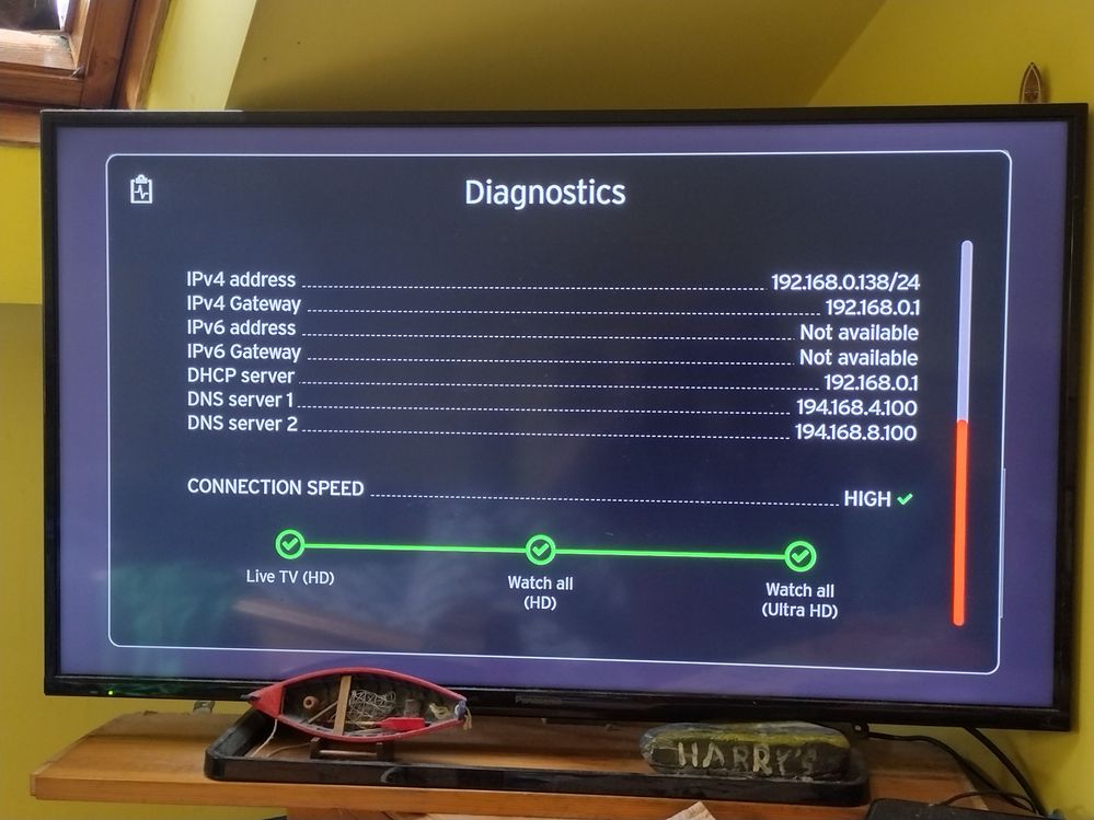

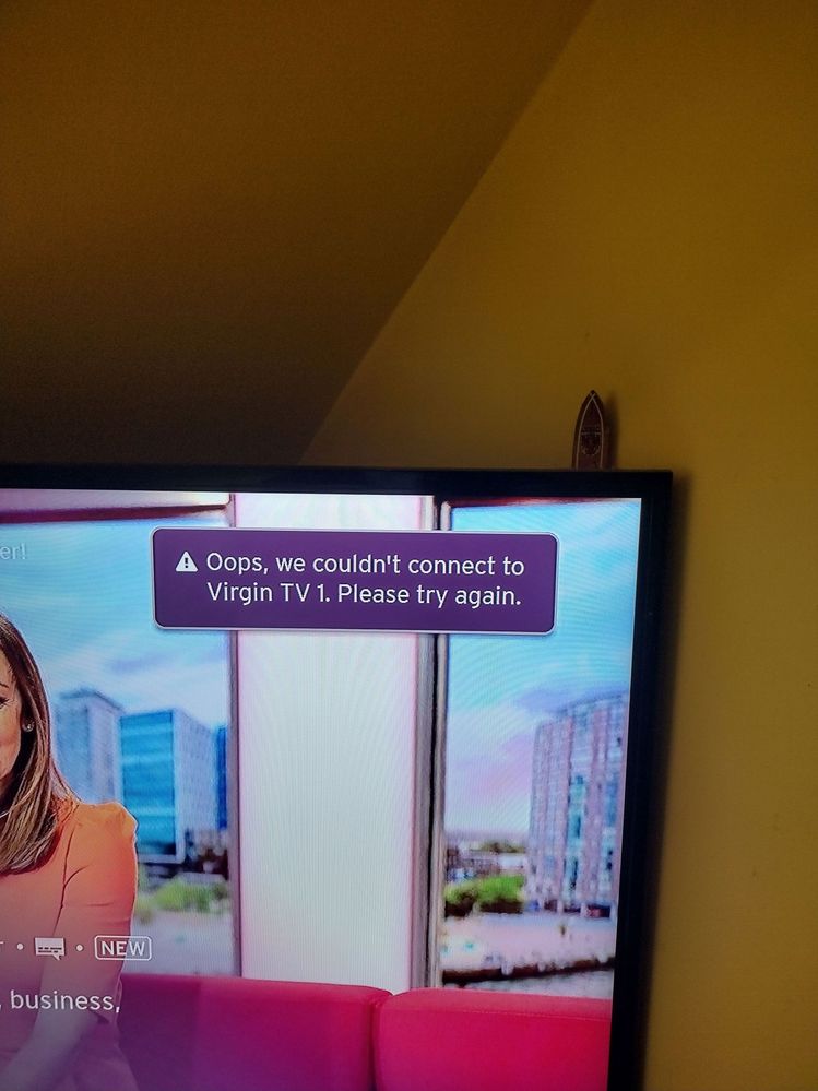

  • Hi Daniel, thank You for your message, I confirm that there are no other error messages or codes on the screen, and that both the main box and the mini box have white lights on the front. I have attached some photos of the actual problem, Kind Regards, Keith

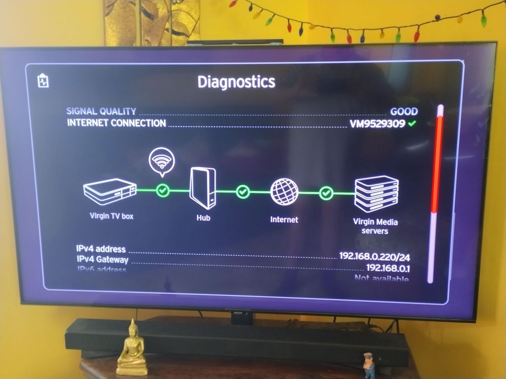

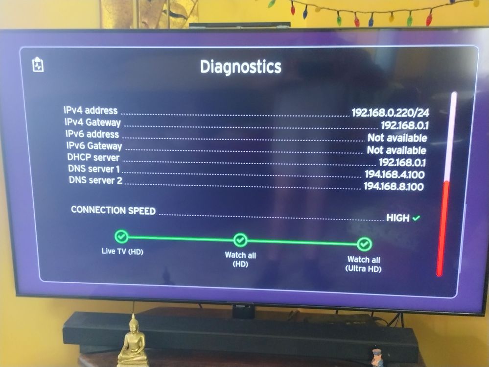

      Hi Travis_M,  I have run the diagnostics on the main TV connected to Main TV1 Box and have attached the results, we don't have any problems with Netflix or iPlayer or youTube any other App on either TV, just playing the recordings on TV2 is the only problem, Thanks, Keith
        Hi Keith
        You could  run the same diagnostics on the other  box to check the internet connection since it's TV2 (the mini box) that isn't connecting to TV1 (the main box) where the recordings are stored.
        If the Main Box isn't ready to accept the request from the mini box then you won't be able to play the recordings.
        The main box needs to be on either Fast Start or Active Start. If it's set to Eco Start, or turned off when the request is made then the Mini box can't see it.
        Go to Settings > System > Standby power consumption. You have 3 choices.
        Fast start  - the 360 starts quickly but is less energy efficient
        Active start - more energy efficient than fast start but the box takes a little longer to start up
        Eco start - the most energy efficient and probably the one you're using. It uses minimal power but takes a while to start.
        The first two options are best if you have a mini box and want to watch a recording on it
