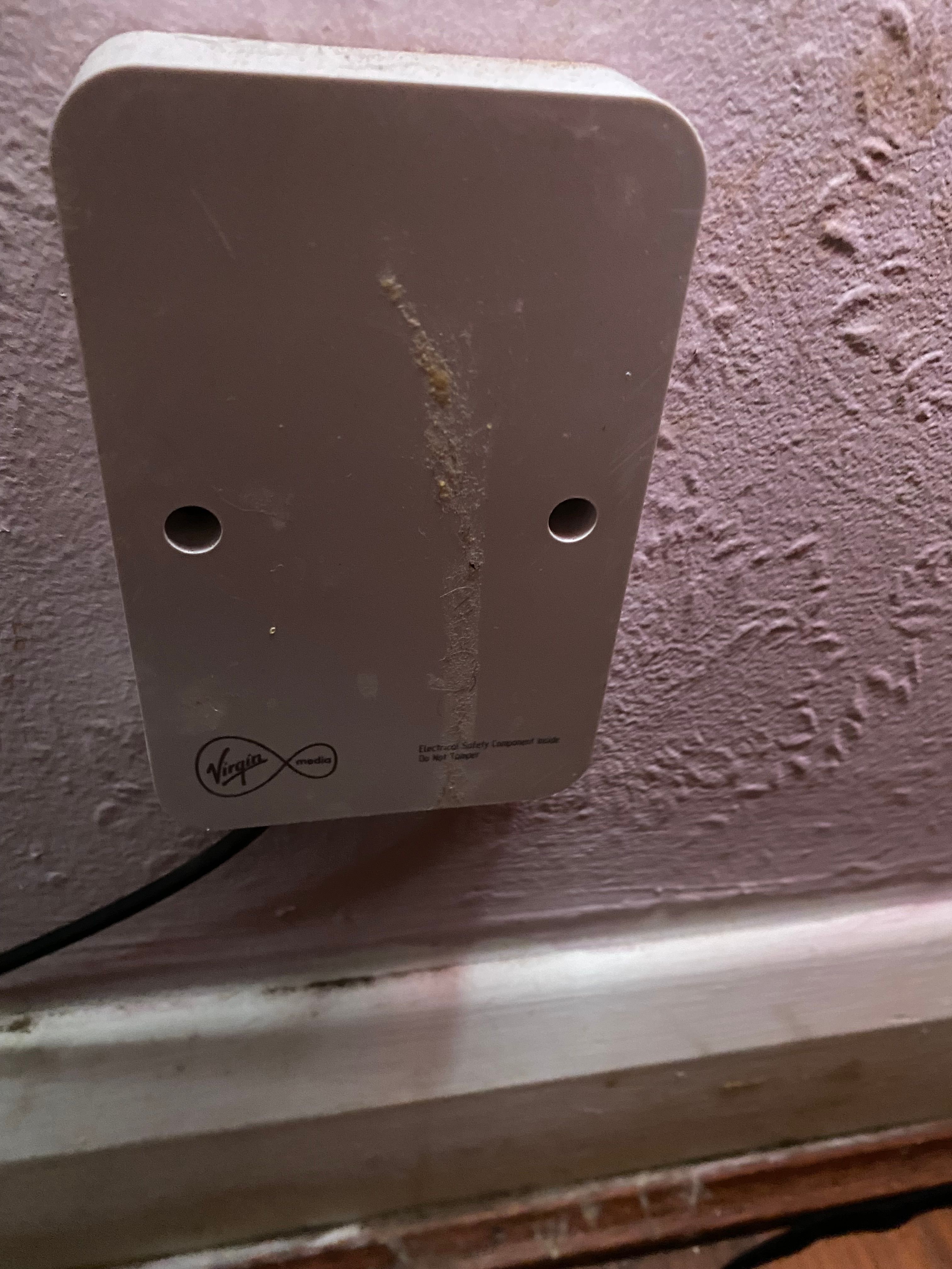

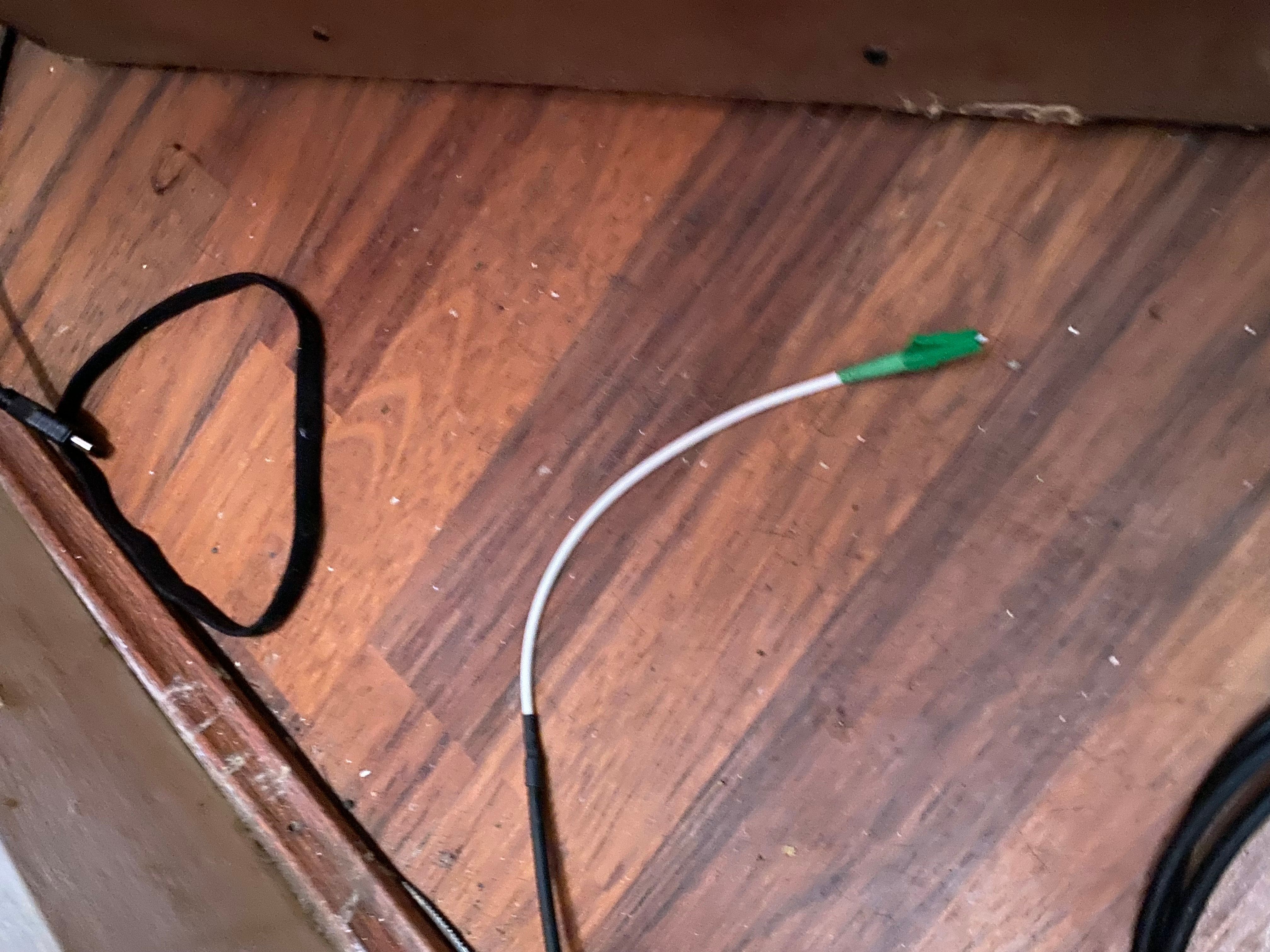

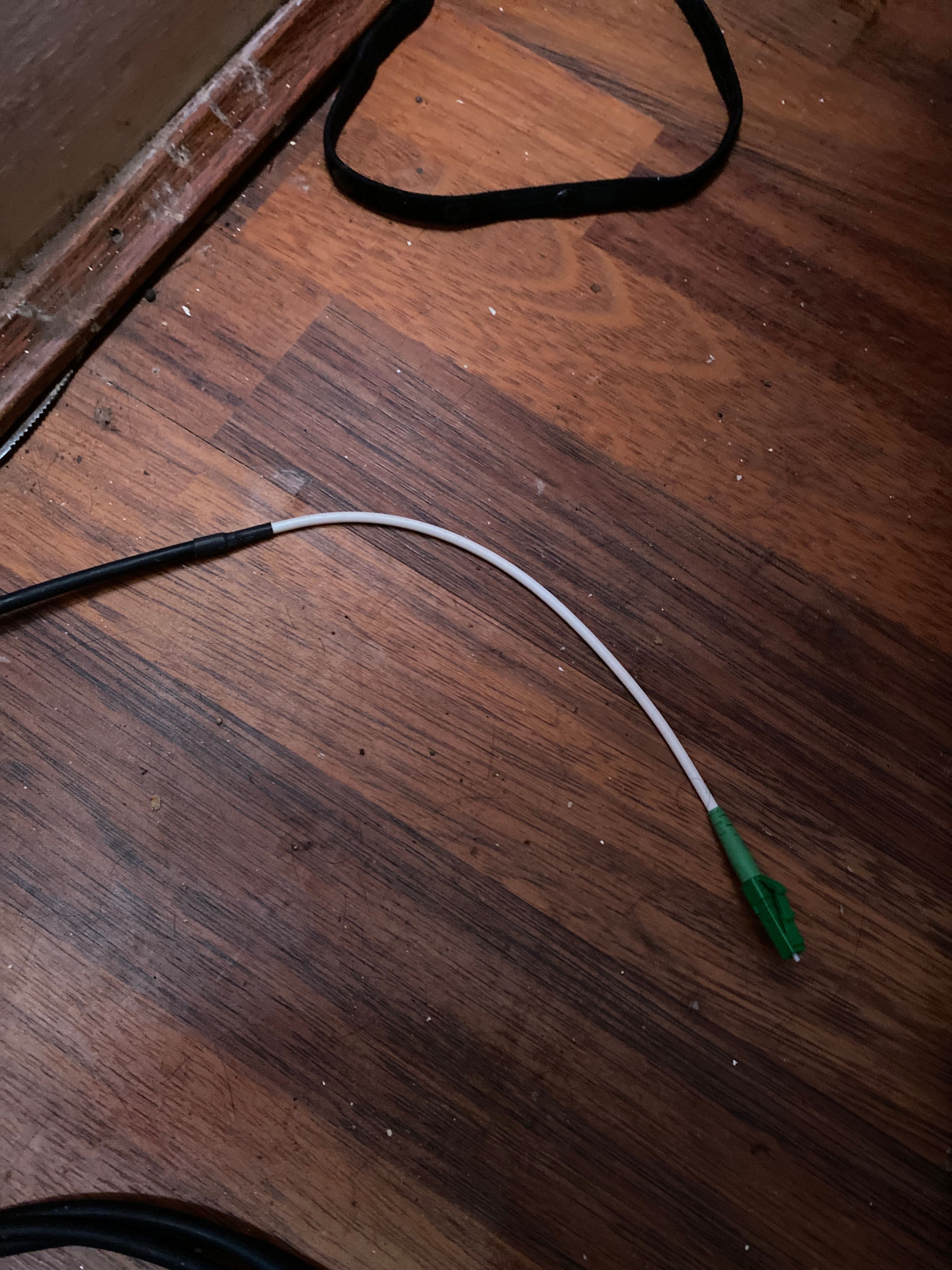

    • shellydy's avatar
      shellydy
      No problem I’ve attached a picture. I actually found a box but it has a lead coming off it.

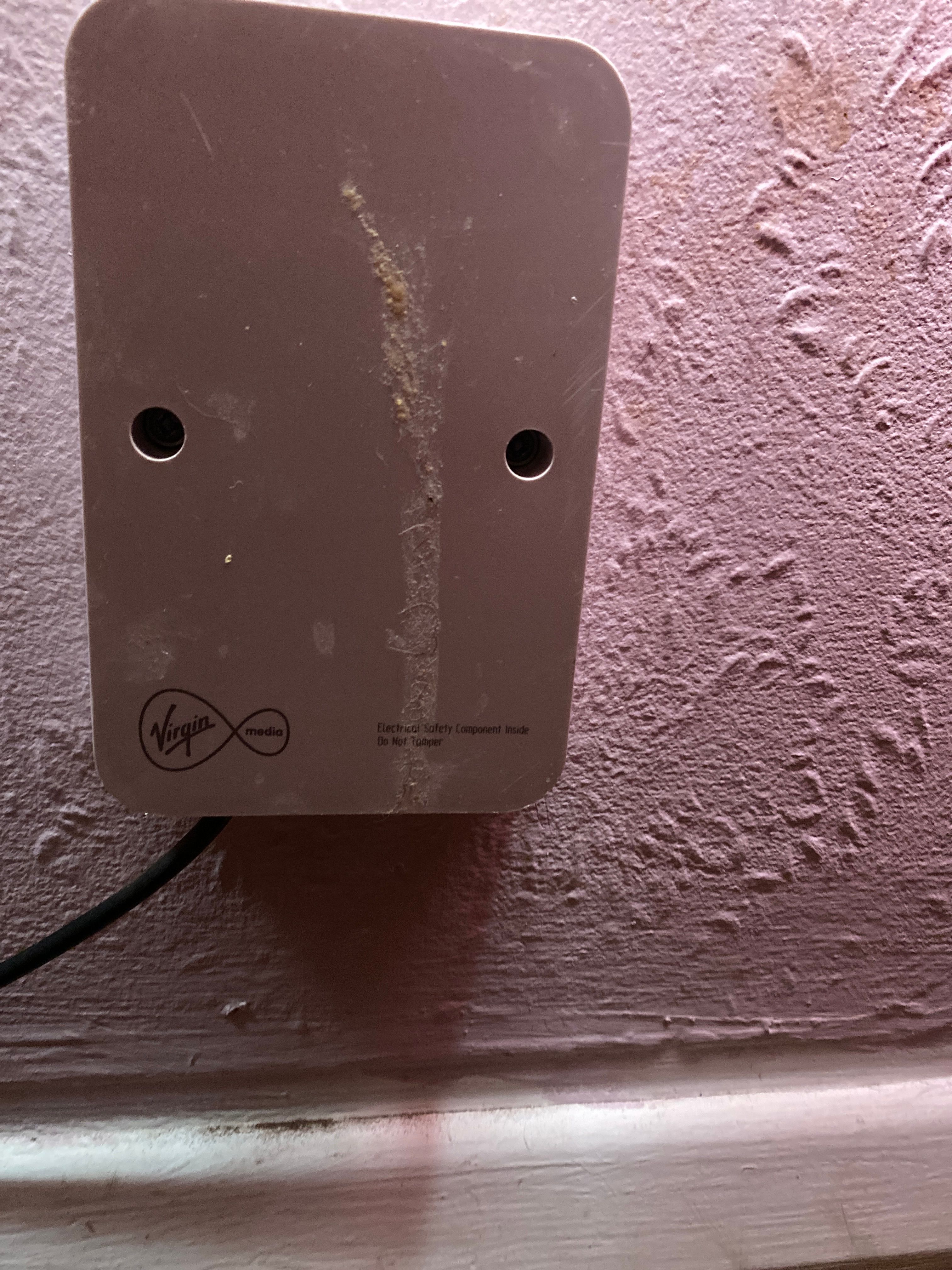

    • shellydy's avatar
      shellydy
      I think that must be Sky as I have since found a virgin box but it doesn’t have the right wire coming out.
  • -tony-'s avatar
    -tony-
    not sure what wire you are showing there - the green end looks like a fibre connection rather than coax - what is your area - fibre or coax from the box - what hub have they sent - post a few more photos showing all the internal wiring and one of the external box
