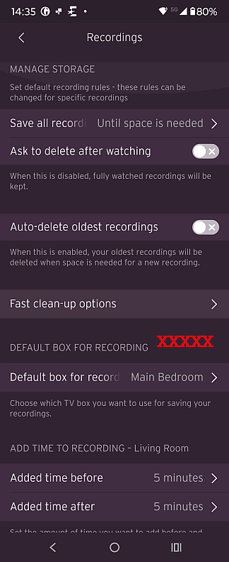

Sometimes when I press record on when watching the living room Virgin 360 box it comes up saying ‘bedroom is starting up’.
Why is it trying to record to the bedroom when I want the recording to be on my living room box?
Is there a way to set the default recording box as the living room as it is always on?

    Do you have multiple master boxes, or only one?
    Hi Anonymous
    The easy way  to set the default recording box as the living room is to open the TVGo app, click on the head and shoulders icon and select Settings > Recordings and scroll down to the Default box for recording section and select your living room box as the default.
    You can also fine tune the recordings between boxes by clicking on the red Record button, then on the next screen click Advanced Options, then on the next screen click on Choose TV Box, then select the box you want the recording to be made on, then click on Record. That program will then be recorded on that box going forward, even if the default recording box is one of the others.
    When setting up a new series link go to Advanced and select which box you want the recording to be made on. It will then be recorded on that box going forward. If though you've already got a series link set up for a particular program and want to change it so it will record on the other box then you need to cancel that series link, and then set it up to record again, using the advanced options when you press record.
