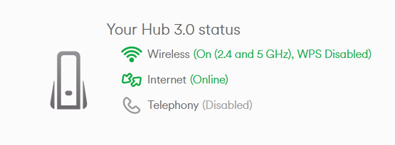

    As advised by Client62 you need to check for telephony being enabled. (When were you advised you'd be migrated to VoIP?) When it is then connect your phone to the hub's TEL 1 port with the RJ11 to BT adapter cable that you are getting.
    The VTECH phone system should not need an ADSL filter / splitter to work on a VM Telephone wall socket.
    You can check if the VM Hub is enabled for telephone from the admin menu's status page,
    this is the first page after logon :
    Telephone is not enabled on our VM Hub and it looks like this :
