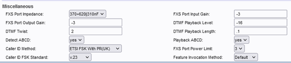

      We have used the Cisco SPA 112 since 2017, it is an alternative to the Grandstream HT801,
      Cisco ATA 191 is the current model.  The key appears to be access to configure the line behaviours,  the choice of Cisco or Grandstream not being important.
      Here from the Cisco SPA 112 are some of the Regional settings I made to emulate a BT line,
      they are mostly similar to those mentioned earlier.
