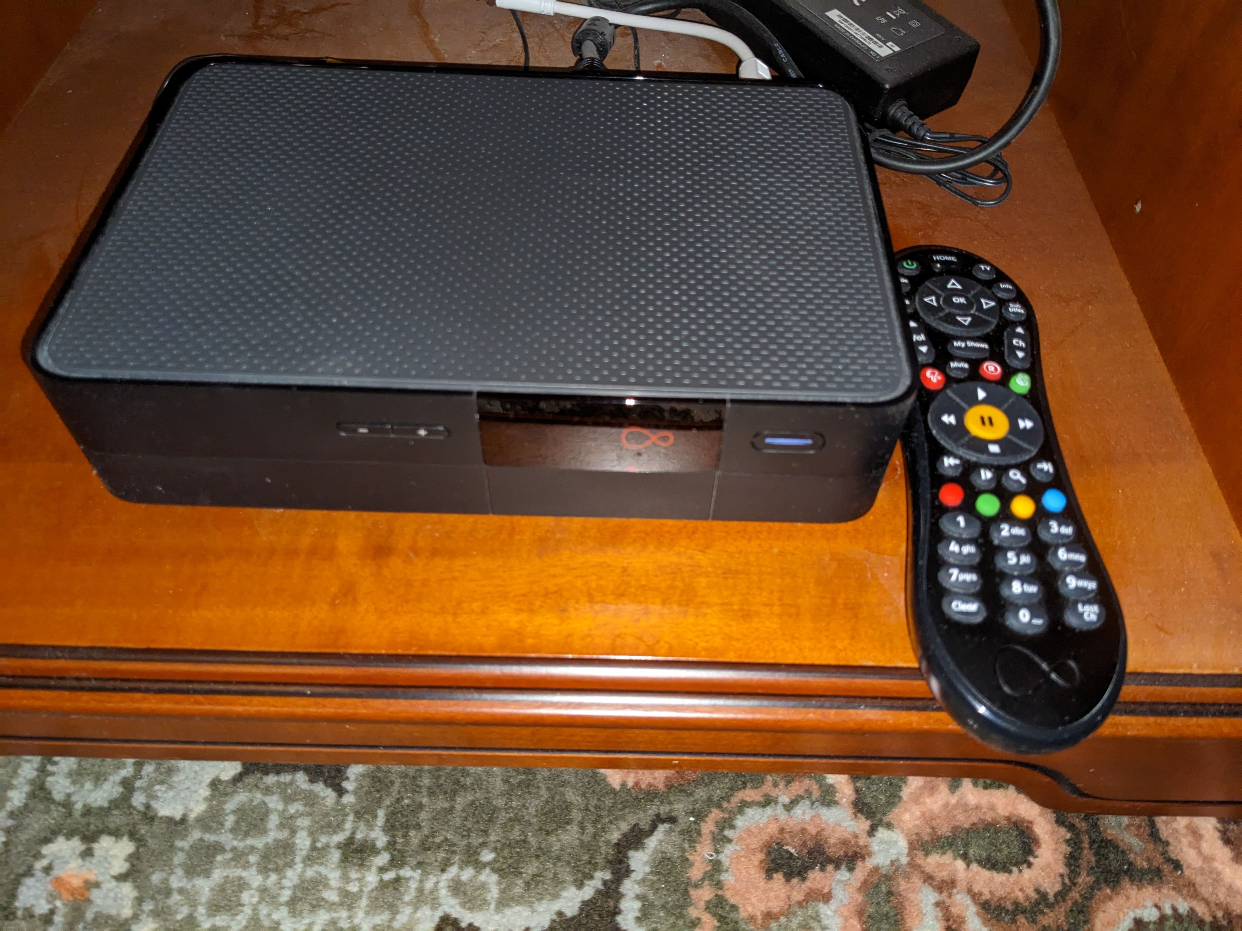

  • Pretty sure I've got a v6, no voice button on my remote control.
  • japitts's avatar
    japitts
    That's a V6, you could also confirm the TiVo-software by checking the video preview screen in the top-right of the UI - does it have the TiVo logo?
