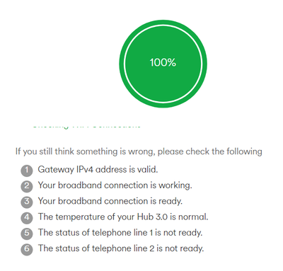

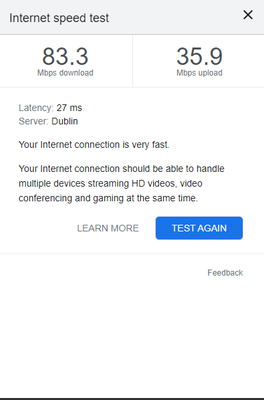

      I have put Hub in Router mode. Connected my PC via Cat 6 Ethernet to the Hub 3, and this is the results. I am on 350Mb. I have done theSpeed Test Link and reset the router, I have done the WiFi Diagnostic and that is all fine. The result below is via a wired connection direct into my hub3 with nothing else connected.

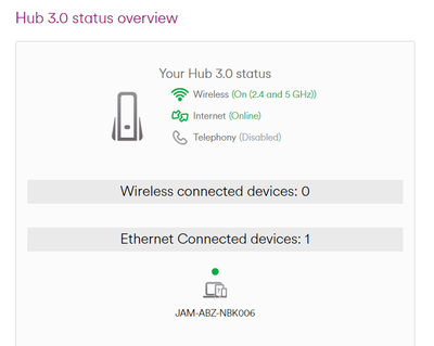

      happydundee
      See here, single device connected to Hub 3 at 1000Mb. so its not my cable:

    Tudor
    The Speedtest show a test server in Dublin and that does not look like a VM UK Speedtest. Are you in Eire?
