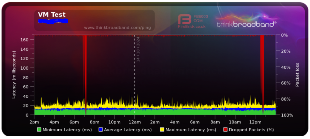

Generally my broadband is fine for normal web access.  However, both my wife and I work from home and I have noticed that we both suffer from interruptions on video/voice calls.  This causes the connection to freeze for 1-2 seconds before resuming.  I ran a BQM and notice that we are consistently dropping packets with our connection.  I have also conducted my own tests by pinging the VM router and an external website while on a video call.  When it freezes, I also see dropped pings to the external website (the VM router ping is fine).
Is there anything that can be done to improve this?

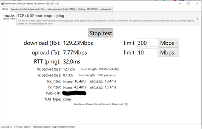

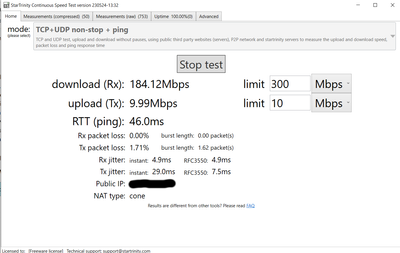

    best to use the default limits then max out the speed as it still tells you the packet loss more correctly without more load

      Hi cookd53
      Thank you for your first post, welcome to the Community Forums.
      I'm sorry to hear you've been struggling a bit with your broadband connection recently. I've had a look and can see that your signal levels are outside of the normal parameters, so I'll need to book in an engineer visit for you to put them right.
      I've popped over a private message so I can take your details.
