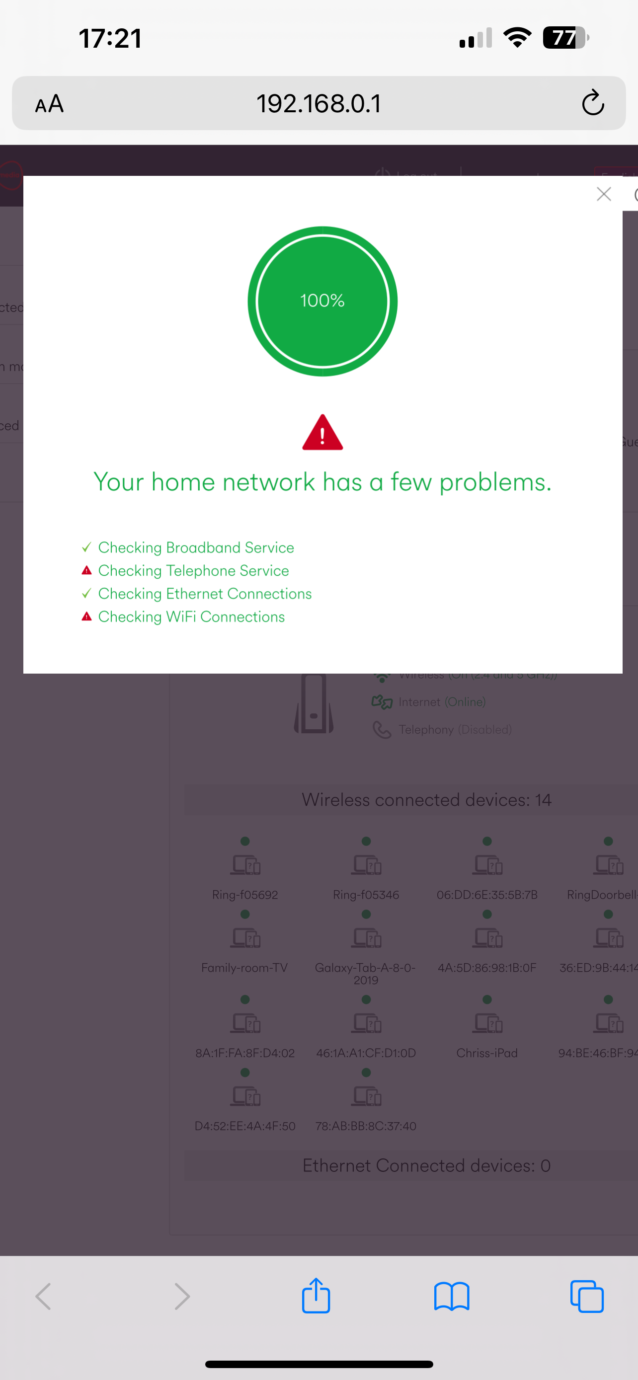

      • ceejay1952's avatar
        ceejay1952
        Since moving house in June the WiFi on our router has been pretty poor and is now dropping a signal every 30 minutes.
        checked forums and did a diagnostic check which came up with this, see screen shot.
        Can I get a new router as the current one is useless?
        My Sky glass TV works okay via Ethernet cable but Sky pucks just keep freezing.
