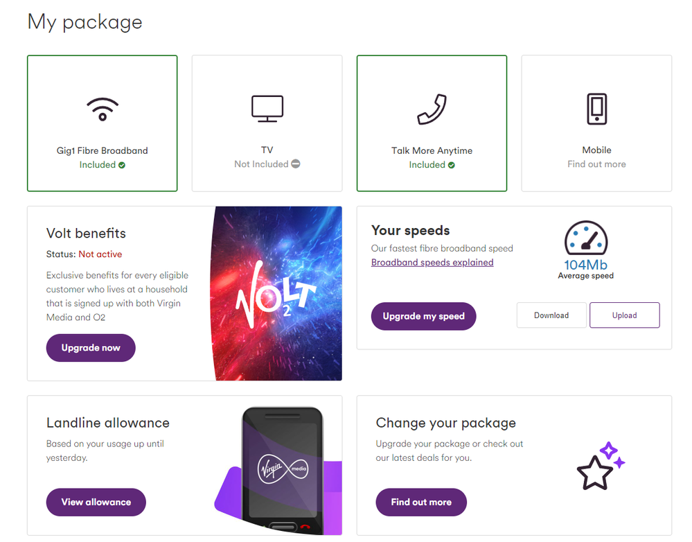

    When accessing your account does your package state the faster upload speed?

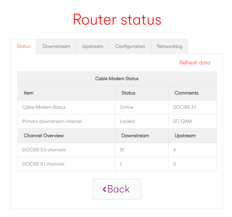

      I only have 4 upstream 3.0 channels and no 3.1 channels. I do have one 3.1 downstream channel

        Although technically four 3.0 upstream channels are capable of 100Mbps I believe you won't 'see' the update from 52Mbps unless you have the additional DOCSIS 3.1 upstream channel.
        Another poster reported a similar issue and they also did not have the fifth channel.
        Your area may still require a hardware upgrade.
  • Hi
    Not seen that page before, useful. Yes it does show 104Mb on the upload

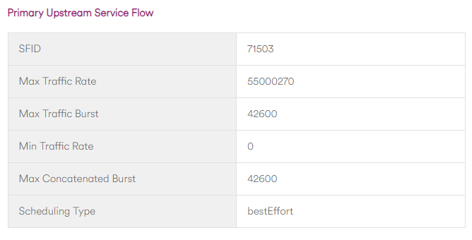

      I have had exactly the same experience. My account shows 104Mbps but my router configuration is still showing the ~55000000bps limit.
      I have explained this again and again on the phone and they don't even understand the basics - keep telling me the expected range is 50-100Mbps therefore no issue.
      I've been going in circles explaining (why should I even need to) that if I have a router config for 54Mbps it is never going to be possible for me to get more than that. The response has been "all gig1 customers get 52Mbps"
