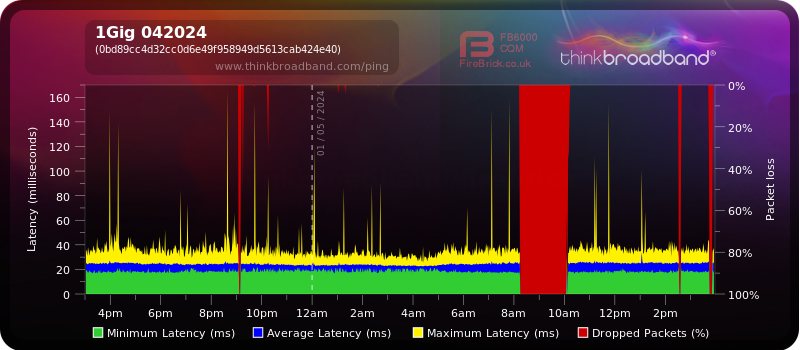

        Dialled in
        I received a Hub 5 to attempt to fix my disconnection issues, it didn’t but exactly the same thing happened to me this morning and a search brought your post up. It wouldn’t go back into modem mode until a sixty seconds reset using the button on the bottom.
        The big red bar is when it went into router mode.
    Does the log show detail just before the reboot into router mode ( perhaps a failing software update ) ?
