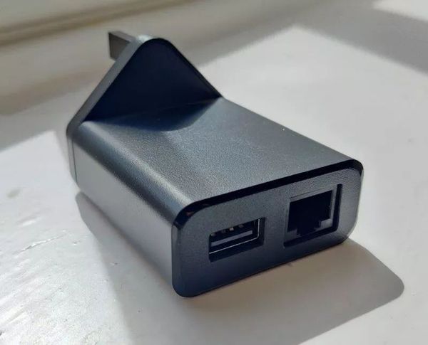

        Hi again rolopes76​
        You say, ' even the TV box only accepts the internet signal via Wi-Fi.'
        If you Stream (Flex) TV box is close enough to the hub 5x, then provided VM have sent the correct power adapter then you can connect the TV via an ethernet cable as the power adapter combines an ethernet port as shown in the picture below.
        When logged into the hub 5x settings, if you click on the Network Log section you might see the options to post the rest of the data that jbrennand​ asked for (2 tables in the Downstream tab, the 2 in the Upstream tab, &  the actual Network Logs)
