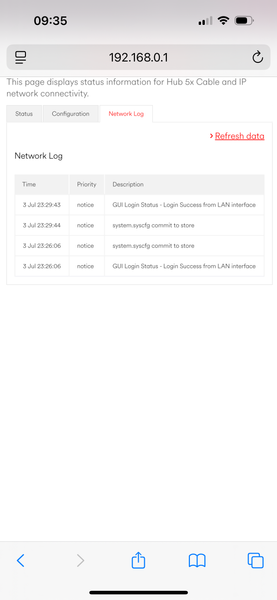

I’ve been considering switching providers, but I’m genuinely trying to understand the root of this issue. Yesterday, before the red light appeared, I accessed the router (even without internet, I can still access it locally) and saw something odd in the “Network Log”:
At the exact time my wife lost signal, the log shows:
“GUI Login Status - Login Success from LAN interface” and
“system.syscfg commit to store”
I’ve attached a screenshot of this.
Can anyone shed some light on what might be going on here? Why is this happening at such regular intervals? What does that system log entry actually mean?

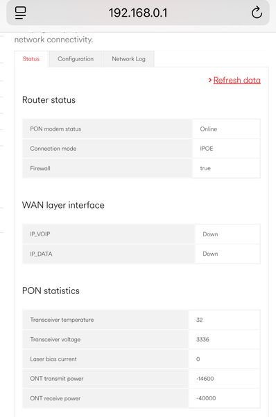

    Your screenshot shows you are using a hub5x so you're in the full fibre area, so your TV is IP based and that explains why you loose the TV service at the same time as the internet service..
    I does seem odd that most disconnections occur on  Tuesday and Wednesday afternoons, however the red light does indicate problems.  Was the loss of internet on Saturday just wifi, or was it wired devices too?

      Signal loss occurs for both Wi-Fi and wired connections, every time.
      My Hub is the 5x model, and the technicians say it’s a fibre optic connection. The television depends on the internet signal as well – even the TV box only accepts the internet signal via Wi-Fi.

      • Roger_Gooner's avatar
        Roger_Gooner
        You should demand a full optical power level test at the Hub 5x (Rx power in dBm). If this shows optical power levels are suspect, the fault is outside the home and the tech needs to investigate the fibre from the distribution cabinet to check the fibre drop from the cabinet to the home, test optical power levels from the splitter and potentially reseat connections within that cabinet. If no fault is found then the problem is probably upstream.
