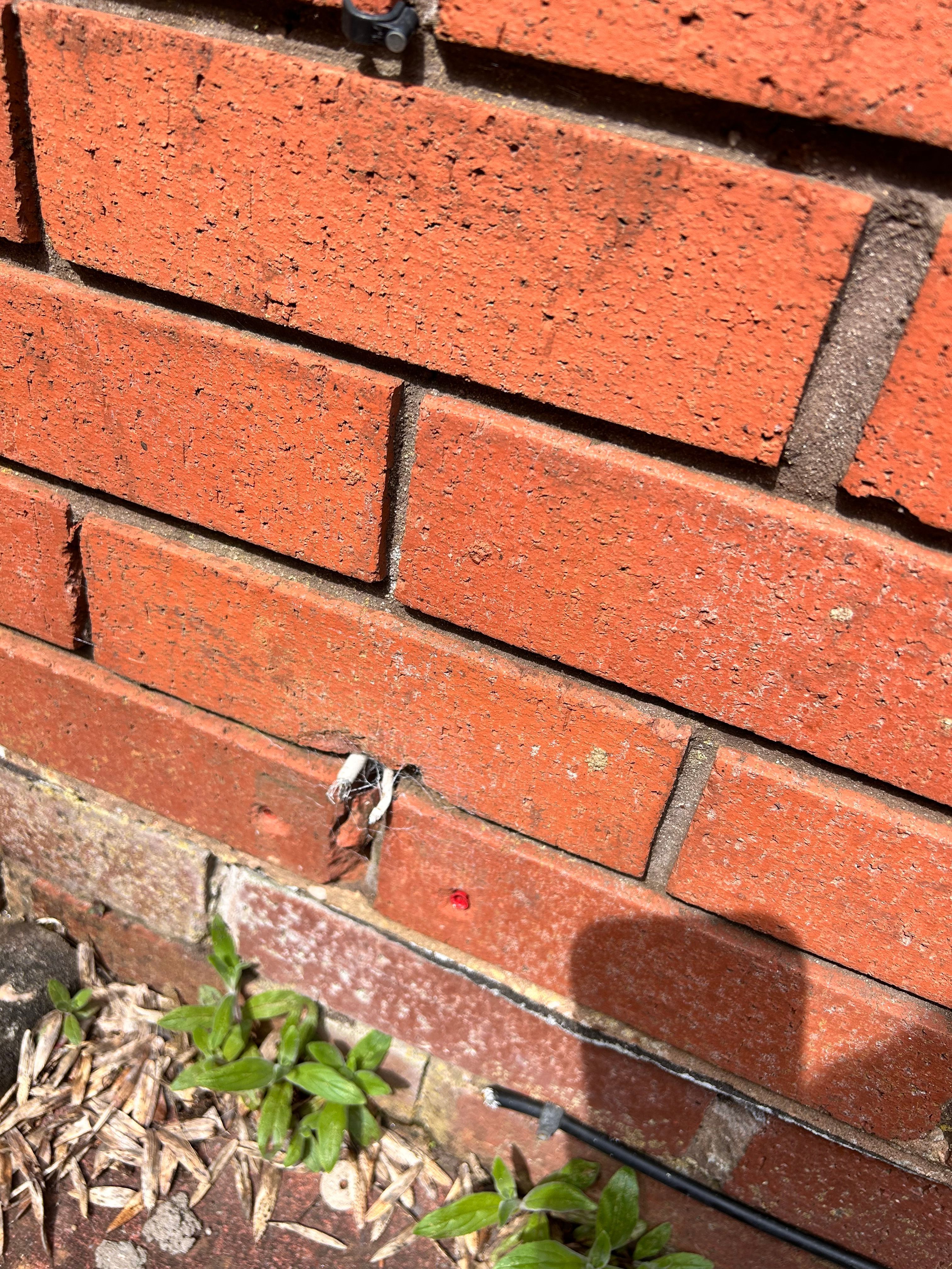

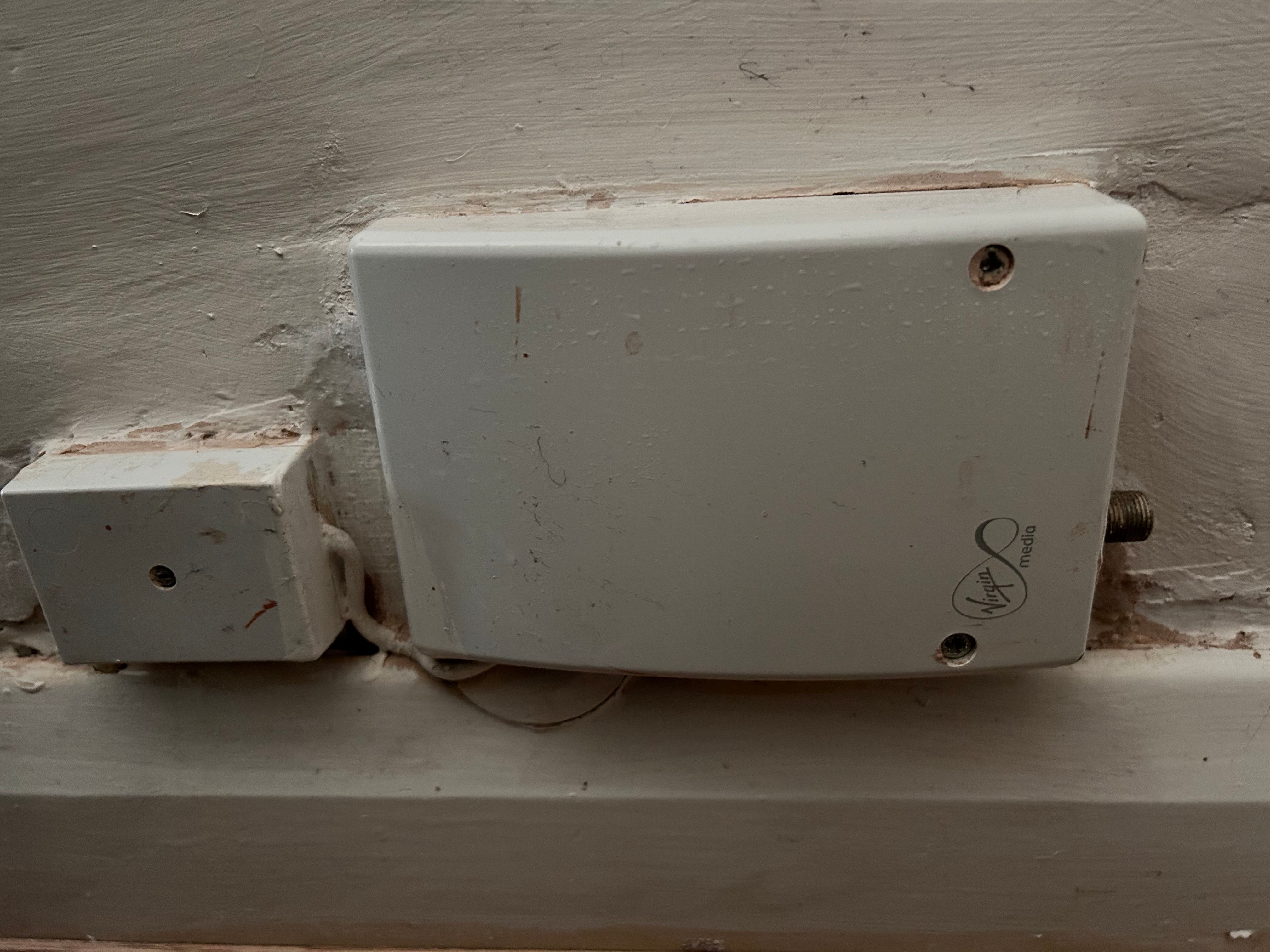

      Thank you for replying me. Here I just took some photos. Pic 1 is the wall socket I found and I don’t know what the small square box is for. Pic 2 is the cable been cut which is on the other side of the  wall where  socket located   Thank you

    You would connect a new VM hub to the big box on the right in pic no.1. But, as you say, it looks as if the black incoming cable in the bottom right of pic. no. 2 and the omnibox outside have been cut and removed.
    On the outside wall you might expect to see a junction box like the one on the left below
    https://www.ispreview.co.uk/wp-content/gallery/2019-article-illustrations/virgin_media_external_wall_box.jpg
    with a connector inside to join the black incoming cable in the bottom right of pic no.2 to the stub of white cable poking through the wall.
    If you are minded to do any more investigating yourself, you could take off the lid of the big white box in your photo no. 1. It will probably look something like this inside
    https://community.virginmedia.com/t5/QuickStart-set-up-and/Virgin-media-wall-socket-for-broadband-is-not-what-js-shown-on/td-p/5400063
    As it appears that your cable is cut outside, the metal isolator box inside will just probably pull away with a connector and a short stub of white cable attached to it.
