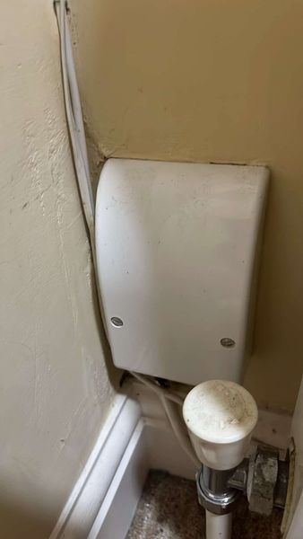

  • This is the connection box , i think its in use for the current router from now tv,
    If it is in use for now tv will i be able to plug the new virgin media router into this or will it be a completely different box/connection?.
    Thanks for the replies.

      That is a bespoke coax network connection to VM, so won't be in use by another ISP.

      That is your VM wall box. Only VM will use that for services. Example in pic no. 2 below shows what is likely to be inside
      https://uktechhub.com/forums/topic/virgin-media-hub-3-m100-fibre-broadband-install/
      In pic. no. 2 above, the black cable is the incoming supply cable and the cable with the red markings coming out of the bottom of the metal isolator box is the Quick Start cable which connects to the VM hub.
      In your own photo, it looks like an extension cable might already be connected to the bottom of your box but can't see the details of that from your pic.
