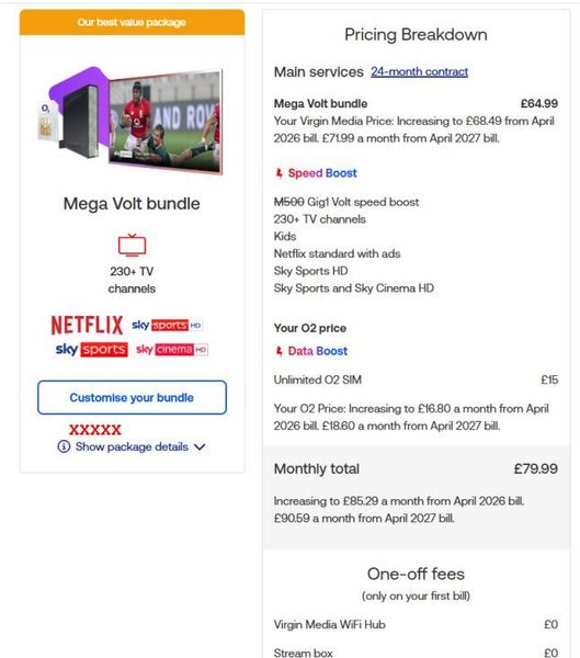

    As to how to order the extra TV boxes, I've provided a complete walk through of the order process below, including a screen shot of the second page of the order process where you have the option to customise your bundle.
    On the website select the Mega Volt bundle
    On the next screen click on "Customise bundle"
    On the next screen click on the speed you would like, and if available in your area it will also offer the option to select an upload speed add-on which gives you an upload speed as fast as your download speed for an additional £6 per month (this is only available on the full fibre packages with speeds up to 2 Gig)
    Then select Continue which loads a screen allowing you add up to 2 extra sims
    The next screen offers a selection of additional add ons (TNT Sports, Premier Sports, and Racing TV.  Select any of those you want added then click on Continue
    On this next screen yo can choose a different Netflix tier, and also add Disney +
    Then click continue, and on this screen you can add up to five additional Stream boxes.  The first addional box is an extra £10 per month, and any further additional boxes are each £5 a month extra (so in your case you would add an extra 3 boxes for an additional £20 per month in total, giving  you the 4 boxes you require)
    The next sceen ask if you have a PAC or STAC from your current mobile provider which you should choose if you want to keep the same mobile number
    Then after clicking Continue you are able to book your engineer appointment
