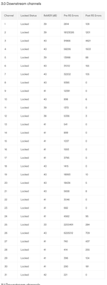

Hi all, All help greatly appreciated. Setup : Smart Hub 5 (modem mode) Issue : Every few hours my internet drops for approx 20-30seconds and then recovers. Observations : There is a lot of US profile assignment change logs. I think this are related to the times when my internet drops. "US profile assignment change. US Chan ID: 6; Previous Profile: 12 13; New Profile: 11 13.;CM-MAC=" Seen a couple of these in the current log. Nowhere near as prevalent "DHCP RENEW WARNING - Field invalid in response v4 option;CM-MAC=" Various errors logged (see screenshots below) What's changed? Have been running the Smart Hub 5 in router mode recently. Don't remember observing this initially but not 100% ruling it out. However, based on the Smart Hub logs it feels this is Smart HUB to Virgin infrastructure issues instead of it being my router plugged into Port 1 of the Smart HUB My next door neighbours recently has had Virgin Media broadband installed. Again I did not notice this initially so think again this is not related. System status : [Seems to be a lot of errors being logged such as] Adding upstream stats for reference And overall status Thanks in advance for any help or guidance185Views0likes8CommentsHigh latency errors on my network (Superhub in modem mode) - Logs attached

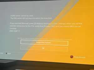

Hi All, Hope someone can help me get my sons PS4 online before the school break as he is only allowed to play during school holidays. The PS4 was fine with our previous provider SKY and also works with my mobile hotspot, however it does not connect to VM wifi. We are new to VM only had our package for a month. I am getting a DNS message and have seareched the web and forums for a solution but still unable to log in. Here are the things I have already done: 1: Restarted the router HUB5 and restarted the PS4 - No luck 2: Turned off Child Safe - Restarted the hub - No luck 3: Manually did the DNS to 8.8.8.8 amd 8.8.4.4 as suggetsed in forum - No luck Please can someone help - Thank you1.3KViews0likes5CommentsRegular dropped packets while gaming & T3 timeout errors

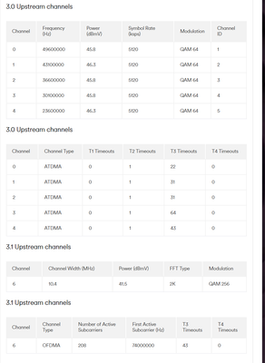

Hi all, Hoping I can get some help here as I have tried to use the online service checker and keep getting sent round in circles with rebooting the hub / factory resetting which hasn't resolved the issue. We have recently moved into this house a couple months back and since the install been receiving on and off issues with the stability of the network which is affecting working from home and online gaming. It will be fine for a few days then we will start seeing dropped packets / packet burst in gaming. When working from home this also kicks off the remote desktop sessions I use. Since this has started getting more frequent I have set up a BQM graph and hopefully the links below will work: 26th: https://www.thinkbroadband.com/broadband/monitoring/quality/share/8e0e268fee776ef7500c7d2376ceba20625b96c8-26-06-2024 27th: https://www.thinkbroadband.com/broadband/monitoring/quality/share/a47b50c4e9688abef5cf89e9bb5f36567846ca82-27-06-2024 Also logs from the hub - I have been keeping an eye on the number of timeouts and this seems to have reset recently as a couple days ago looked like this: If you need any more information let me know! Thanks. Network Log Time Priority Description 27-06-2024 13:34:48 critical Started Unicast Maintenance Ranging - No Response received - T3 time-out;CM-MAC=**:**:**:**:**:**;CMTS-MAC=**:**:**:**:**:**;CM-QOS=1.1;CM-VER=3.1; 27-06-2024 11:09:16 error DHCP RENEW WARNING - Field invalid in response v4 option;CM-MAC=**:**:**:**:**:**;CMTS-MAC=**:**:**:**:**:**;CM-QOS=1.1;CM-VER=3.1; 27-06-2024 09:47:56 critical 16 consecutive T3 timeouts while trying to range on upstream channel 8;CM-MAC=**:**:**:**:**:**;CMTS-MAC=**:**:**:**:**:**;CM-QOS=1.1;CM-VER=3.1; 27-06-2024 09:47:56 critical Unicast Maintenance Ranging attempted - No response - Retries exhausted;CM-MAC=**:**:**:**:**:**;CMTS-MAC=**:**:**:**:**:**;CM-QOS=1.1;CM-VER=3.1; 27-06-2024 09:46:48 critical Started Unicast Maintenance Ranging - No Response received - T3 time-out;CM-MAC=**:**:**:**:**:**;CMTS-MAC=**:**:**:**:**:**;CM-QOS=1.1;CM-VER=3.1; 25-06-2024 02:54:04 notice REGISTRATION COMPLETE - Waiting for Operational status 25-06-2024 02:54:01 notice US profile assignment change. US Chan ID: 6; Previous Profile: 13; New Profile: 11 13.;CM-MAC=**:**:**:**:**:**;CMTS-MAC=**:**:**:**:**:**;CM-QOS=1.1;CM-VER=3.1; 25-06-2024 02:53:55 notice DS profile assignment change. DS Chan ID: 32; Previous Profile: ; New Profile: 1 2 3.;CM-MAC=**:**:**:**:**:**;CMTS-MAC=**:**:**:**:**:**;CM-QOS=1.1;CM-VER=3.1; 25-06-2024 02:53:52 notice TLV-11 - unrecognized OID;CM-MAC=**:**:**:**:**:**;CMTS-MAC=**:**:**:**:**:**;CM-QOS=1.1;CM-VER=3.1; 25-06-2024 02:53:50 warning DHCP WARNING - Non-critical field invalid in response ;CM-MAC=**:**:**:**:**:**;CMTS-MAC=**:**:**:**:**:**;CM-QOS=1.1;CM-VER=3.1; 25-06-2024 02:53:47 notice Honoring MDD; IP provisioning mode = IPv4 25-06-2024 02:53:39 critical SYNC Timing Synchronization failure - Failed to acquire QAM/QPSK symbol timing;;CM-MAC=**:**:**:**:**:**;CMTS-MAC=**:**:**:**:**:**;CM-QOS=1.1;CM-VER=3.1; 25-06-2024 02:53:38 critical Cable Modem Reboot because of - Software_Upgrade 25-06-2024 02:51:36 alert SW download Successful - Via Config file 25-06-2024 02:48:41 alert SW Download INIT - Via Config file cmreg-vmdg660-bbt076-b.cm 25-06-2024 02:48:03 critical SYNC Timing Synchronization failure - Failed to acquire QAM/QPSK symbol timing;;CM-MAC=**:**:**:**:**:**;CMTS-MAC=**:**:**:**:**:**;CM-QOS=1.1;CM-VER=3.1; 25-06-2024 02:48:03 critical Cable Modem Reboot because of - unknown 20-06-2024 15:37:11 critical Started Unicast Maintenance Ranging - No Response received - T3 time-out;CM-MAC=**:**:**:**:**:**;CMTS-MAC=**:**:**:**:**:**;CM-QOS=1.1;CM-VER=3.1; 19-06-2024 14:21:13 critical Started Unicast Maintenance Ranging - No Response received - T3 time-out;CM-MAC=**:**:**:**:**:**;CMTS-MAC=**:**:**:**:**:**;CM-QOS=1.1;CM-VER=3.1; 12-06-2024 14:54:51 critical Started Unicast Maintenance Ranging - No Response received - T3 time-out;CM-MAC=**:**:**:**:**:**;CMTS-MAC=**:**:**:**:**:**;CM-QOS=1.1;CM-VER=3.1; 12-06-2024 14:17:54 critical Unicast Maintenance Ranging attempted - No response - Retries exhausted;CM-MAC=**:**:**:**:**:**;CMTS-MAC=**:**:**:**:**:**;CM-QOS=1.1;CM-VER=3.1; 12-06-2024 14:17:54 critical 16 consecutive T3 timeouts while trying to range on upstream channel 8;CM-MAC=**:**:**:**:**:**;CMTS-MAC=**:**:**:**:**:**;CM-QOS=1.1;CM-VER=3.1; 12-06-2024 14:16:46 critical Started Unicast Maintenance Ranging - No Response received - T3 time-out;CM-MAC=**:**:**:**:**:**;CMTS-MAC=**:**:**:**:**:**;CM-QOS=1.1;CM-VER=3.1; 09-06-2024 13:29:20 critical Started Unicast Maintenance Ranging - No Response received - T3 time-out;CM-MAC=**:**:**:**:**:**;CMTS-MAC=**:**:**:**:**:**;CM-QOS=1.1;CM-VER=3.1; 09-06-2024 06:57:10 critical Started Unicast Maintenance Ranging - No Response received - T3 time-out;CM-MAC=**:**:**:**:**:**;CMTS-MAC=**:**:**:**:**:**;CM-QOS=1.1;CM-VER=3.1; 07-06-2024 15:36:07 critical Started Unicast Maintenance Ranging - No Response received - T3 time-out;CM-MAC=**:**:**:**:**:**;CMTS-MAC=**:**:**:**:**:**;CM-QOS=1.1;CM-VER=3.1; 07-06-2024 11:17:57 critical Started Unicast Maintenance Ranging - No Response received - T3 time-out;CM-MAC=**:**:**:**:**:**;CMTS-MAC=**:**:**:**:**:**;CM-QOS=1.1;CM-VER=3.1; 06-06-2024 17:29:28 critical Started Unicast Maintenance Ranging - No Response received - T3 time-out;CM-MAC=**:**:**:**:**:**;CMTS-MAC=**:**:**:**:**:**;CM-QOS=1.1;CM-VER=3.1; 04-06-2024 06:10:19 critical Started Unicast Maintenance Ranging - No Response received - T3 time-out;CM-MAC=**:**:**:**:**:**;CMTS-MAC=**:**:**:**:**:**;CM-QOS=1.1;CM-VER=3.1; 03-06-2024 12:37:13 critical Started Unicast Maintenance Ranging - No Response received - T3 time-out;CM-MAC=**:**:**:**:**:**;CMTS-MAC=**:**:**:**:**:**;CM-QOS=1.1;CM-VER=3.1; 23-05-2024 05:18:03 critical Started Unicast Maintenance Ranging - No Response received - T3 time-out;CM-MAC=**:**:**:**:**:**;CMTS-MAC=**:**:**:**:**:**;CM-QOS=1.1;CM-VER=3.1; 23-05-2024 02:50:48 critical Started Unicast Maintenance Ranging - No Response received - T3 time-out;CM-MAC=**:**:**:**:**:**;CMTS-MAC=**:**:**:**:**:**;CM-QOS=1.1;CM-VER=3.1; 3.0 Downstream channels Channel Frequency (Hz) Power (dBmV) SNR (dB) Modulation Channel ID 1 331000000 6.2 41 QAM 256 25 2 147000000 6.9 40 QAM 256 2 3 155000000 7 40 QAM 256 3 4 163000000 7.5 40 QAM 256 4 5 171000000 7.2 41 QAM 256 5 6 179000000 6.8 41 QAM 256 6 7 187000000 6.6 41 QAM 256 7 8 195000000 7 41 QAM 256 8 9 203000000 6.8 40 QAM 256 9 10 211000000 7 41 QAM 256 10 11 219000000 6.2 40 QAM 256 11 12 227000000 6.1 40 QAM 256 12 13 235000000 6.5 40 QAM 256 13 14 243000000 6.8 40 QAM 256 14 15 251000000 6.3 40 QAM 256 15 16 259000000 6.4 40 QAM 256 16 17 267000000 7.3 41 QAM 256 17 18 275000000 7.5 41 QAM 256 18 19 283000000 6.8 41 QAM 256 19 20 291000000 7.1 41 QAM 256 20 21 299000000 7.4 41 QAM 256 21 22 307000000 7 41 QAM 256 22 23 315000000 6.2 41 QAM 256 23 24 323000000 6.1 41 QAM 256 24 25 339000000 6.7 41 QAM 256 26 26 347000000 6.7 41 QAM 256 27 27 355000000 6.2 41 QAM 256 28 28 363000000 5.8 41 QAM 256 29 29 371000000 6.4 41 QAM 256 30 30 379000000 6.5 41 QAM 256 31 31 387000000 5.8 41 QAM 256 32 3.0 Downstream channels Channel Locked Status RxMER (dB) Pre RS Errors Post RS Errors 1 Locked 41 18 0 2 Locked 40 9 0 3 Locked 40 9 0 4 Locked 40 6 0 5 Locked 41 4 0 6 Locked 41 6 0 7 Locked 41 3 0 8 Locked 41 4 0 9 Locked 40 1 0 10 Locked 41 4 0 11 Locked 40 8 0 12 Locked 40 8 0 13 Locked 40 11 0 14 Locked 40 13 0 15 Locked 40 10 0 16 Locked 40 12 0 17 Locked 41 9 0 18 Locked 41 8 0 19 Locked 41 6 0 20 Locked 41 11 0 21 Locked 41 10 0 22 Locked 41 16 0 23 Locked 41 26 0 24 Locked 41 13 0 25 Locked 41 19 0 26 Locked 41 19 0 27 Locked 41 22 0 28 Locked 41 29 0 29 Locked 41 24 0 30 Locked 41 33 0 31 Locked 41 36 0 3.1 Downstream channels Channel Channel Width (MHz) FFT Type Number of Active Subcarriers Modulation (Active Profile) First Active Subcarrier (Hz) 33 94 4K 1840 QAM 4096 1108 3.1 Downstream channels Channel ID Locked Status RxMER Data (dB) PLC Power (dBmV) Corrected errors (Active Profile) Uncorrectable errors (Active Profile) 33 Locked 39 -2.6 2756218066 9 3.0 Upstream channels Channel Frequency (Hz) Power (dBmV) Symbol Rate (ksps) Modulation Channel ID 0 49600000 45.3 5120 QAM 64 1 1 43100000 45.8 5120 QAM 64 2 2 36600000 45.5 5120 QAM 64 3 3 30100000 45.5 5120 QAM 64 4 4 23600000 46 5120 QAM 64 5 3.0 Upstream channels Channel Channel Type T1 Timeouts T2 Timeouts T3 Timeouts T4 Timeouts 0 ATDMA 0 0 0 0 1 ATDMA 0 0 0 0 2 ATDMA 0 0 0 0 3 ATDMA 0 0 6 0 4 ATDMA 0 0 0 0 3.1 Upstream channels Channel Channel Width (MHz) Power (dBmV) FFT Type Modulation 6 10.4 41.0 2K QAM 256 3.1 Upstream channels Channel Channel Type Number of Active Subcarriers First Active Subcarrier (Hz) T3 Timeouts T4 Timeouts 6 OFDMA 208 74000000 18 0887Views0likes8CommentsUnable to Access Google Services
