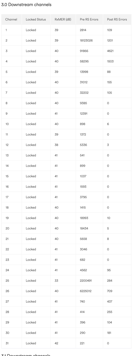

  • Various errors logged (see screenshots below)

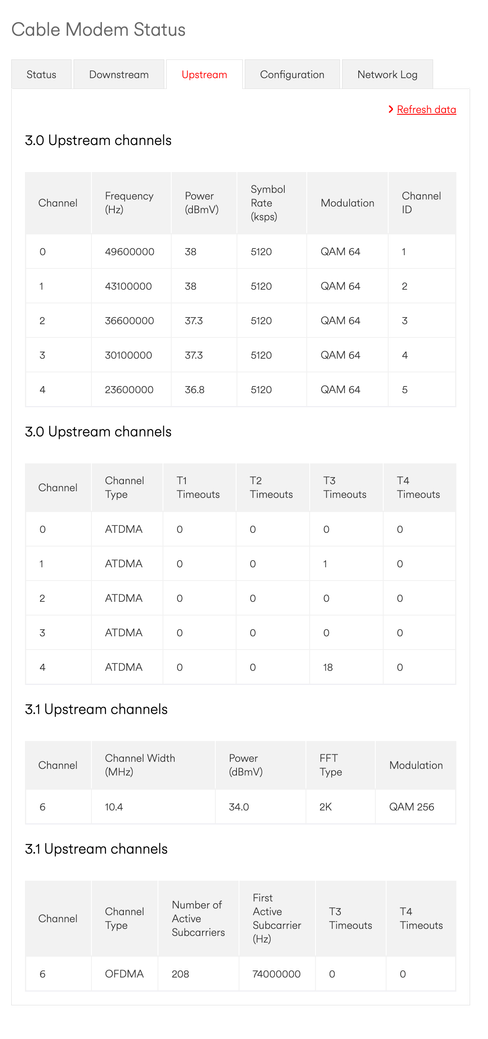

Adding upstream stats for reference

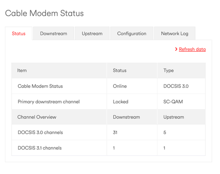

And overall status

  • Far too many Pre RS errors on some channels, as well as channel 25 not looking too happy on RxMER (dB) (SNR).
    Looks like some interference is causing profile changes.
    Check for local faults:

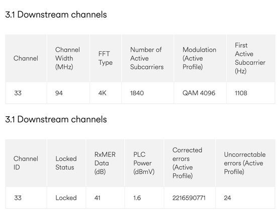

  • Thank you both. I spoke to first line support, and we have factory reset the smart hub. I am seeing within 30mins of this over 400,000 Dwonstream Corrected Errors (Active Profile).  I have assumed both up and downstream errors represent the Virgin Media <-> Smart Hub legs? Can I rule out LAN host issues?
    Yes, nothing about the LAN. There is “noise” on your VM circuit and this will cause the PostRS errors.  You can ignore the 3.1 Corrected errors. It’s the uncorrected errors that are a problem.   VM will need to identify the fault and fix it.

      Thank you, Adduxi. For my clarity and further learning, could you elaborate on the statement, "You can ignore the 3.1 Corrected errors"? I understand that all hardware will inevitably experience some background errors, which are corrected by the hardware or software within the networking stack. However, isn't there a threshold at which an increase in these errors warrants further investigation?   - Just as a FYI. I have now clocked 70 million corrected errors in approx 1 hr

    My DS 3.1 corrected errors with 72 day uptime are currently 580,162,731  so that's a lot.  Does it impact the broadband?  Not that I can tell, and my BQM is excellent.  My PostRS errors on the DS 3.0 channels are zero.  I don't think I can ask for a better circuit.  The Hub 5 has always reported stupidly big numbers for that field as far as I can remember.
    I would only be concerned if the PostRS errors on the DS 3.0 channels started to rise.
