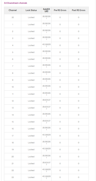

The Superhub4 has been replaced, it shows no significant log entries, retries or noisy channels

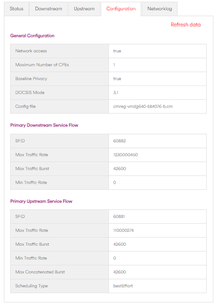

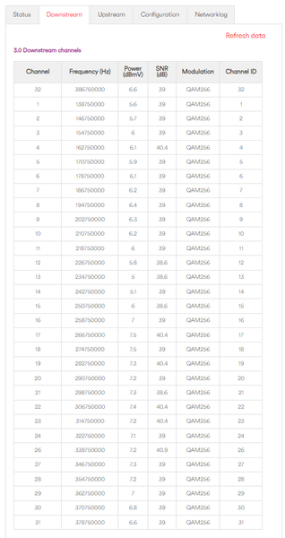

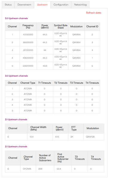

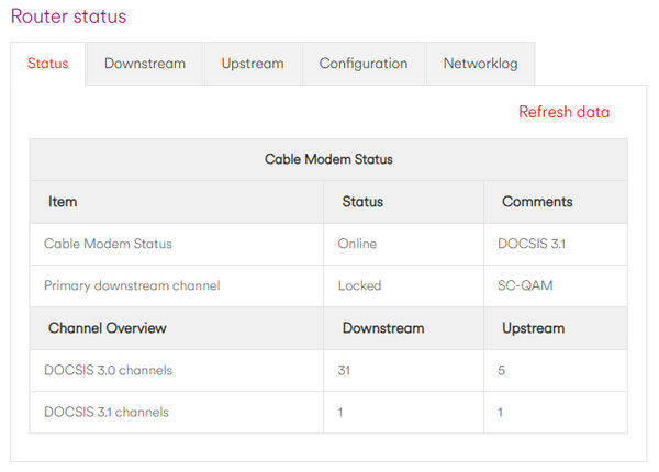

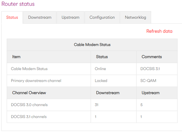

Superhub4 stats :
[Mod - MAC image removed for security]

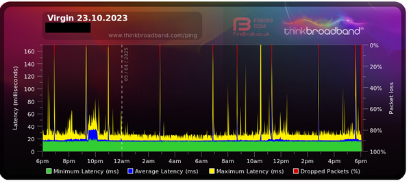

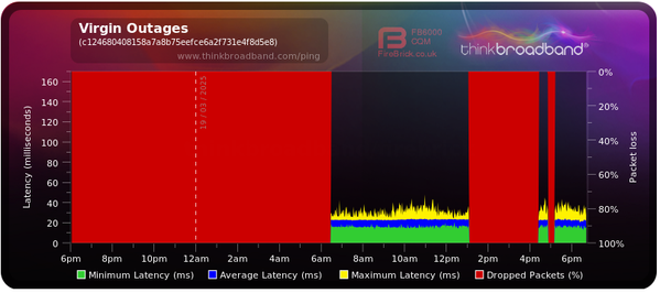

BQM :
 (https://www.thinkbroadband.com/broadband/monitoring/quality/share/75fc8a208f3a2f37294b9ada0a14756a7fee4517)
Whilst long periods of packet loss are recorded, Internet was not lost.  I will log Micro-outages and update here any correlations (or lack thereof).

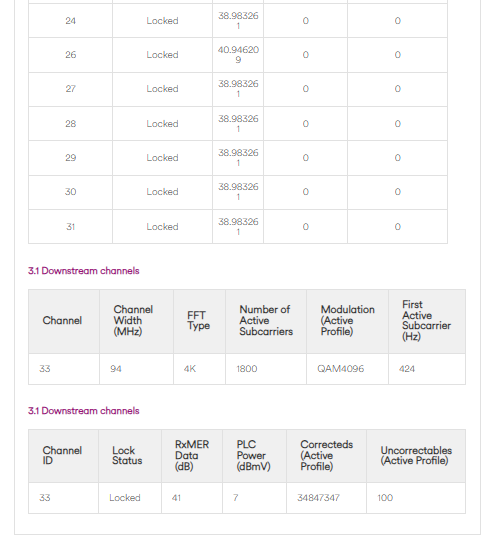

        From checking the connection and equipment, it looks like the Hub was rebooted a couple of hours ago and all of the levels and specs look to be in the ranges we'd expect them to be. A couple of the downstream power levels are a little out but nothing wildly impacting. Speeds seem to have been steady over the last couple of days at 1140Mbps download and 103Mbps upload.
