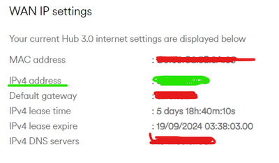

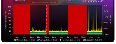

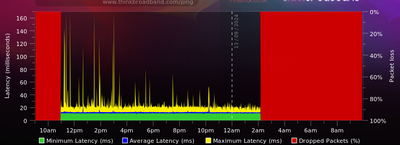

    The Upstream and Downstream power levels look at least as good as ours and we don;t have Teams dropouts or glitches when streaming TV.
    Note the BQM should be configured to point to the Public PIv4 of the VM Hub,
    it should not be configured to point to the IP of the office VPN's exit point.
    The 3 red sections imply there was no response during those hours,
    was it the case that you suffered a total loss of internet during those hours ?
    If not what is this BQM graph actually reporting ?
    Because the red paint suggests BQM is pinging at a device that is not always powered on.

      it's weird isn't it. the internet is working ok right now yet it's showing as 100% dropped packets. perhaps i've set up the monitor incorrectly, it's set up using the ipv4 address
      • maxwellhill's avatar
        maxwellhill
        to be clear, when i say the internet is working ok, i mean it appears to be fine for all devices other than my work laptop via the VPN. while i'm not 100% sure i would detect intermittent dropouts so much due to a different usage pattern on other devices i have used my phone on the wifi for teams calls with success
