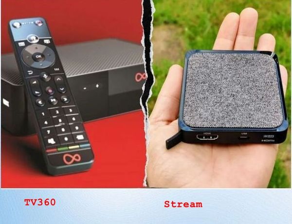

    You've posted in the TV360 forum, but as a new customer you would normally have been supplied with a Stream box, unless you are in an old cable area and spoke to Sales and specifically requested the recordable 360 box, and paid an additional £49.95 activation fee for the 360 box.
    The Stream box became the default TV choice for all of VM's new customers around 4 months ago.  I've posted a picture showing the two boxes below.
    The TV360 box works via a cable connection.   The Stream box is IP based and the live TV channels are streamed over the internet.   The Stream box must be connected to VM broadband, either via an ethernet cable or over wifi.  If you are using a VPN then it won't be classed as a VM internet connection and thus will probably show the message, "it look's like you aren't at home" or something similair.   If you are using a VPN turn it off and then try.

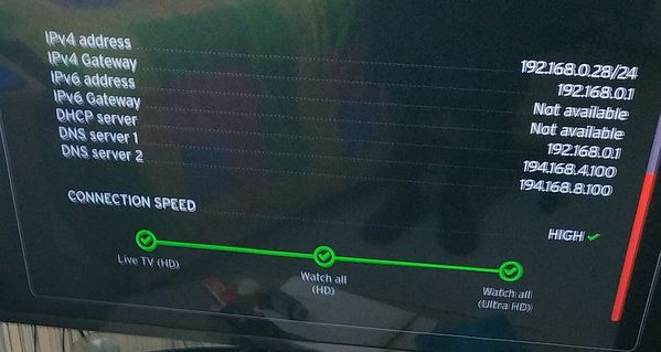

        Also, please look under Settings > System > Diagnostics
        Hopefully the bottom screen looks like the one shown below and that  your IPv4 gatway is 192.168.0.1  and your DNS Server 1 is 194.168.4.100 and DNS Server 2 is 194.168.8.100  which are the correct VM settings for being at home.
